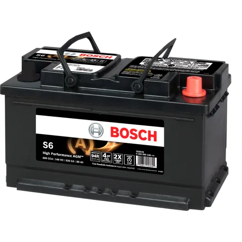

I changed mine out in my 2017 MCS and put in a Bosch S6587B 800 CCA AGM battery. I am very pleased so far

PClay - on that Bosch batt. Do You run a monthly charge program on that item ? How much did you pay for that batt. I Like It ! yesterday in the rain I jumped in car, fired it up, turned on A/C, radio, wipers, parking lt.s, went for 10 mile ride. came back, turned off everthin on my street & parked in my covered shed. Killed the car & it didn't say a thing ! IT 'S GOT GREMLINS ! Have to try it again today
