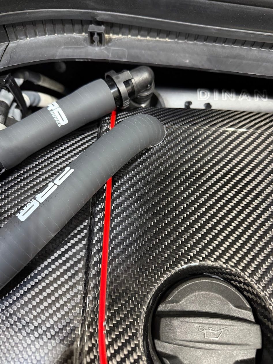

Wanted to revive this and check if anyone found a CC or if the above fits the LCI2 F56.

I have purchased this to give it a go to see if i am able to fit on a 2024 F56 LCI2. I do see the LCI2 does have a additional vacuum line with small canister but think i can rearrange. The other connectors look to be the same. I will report back after it ships over from the UK.

Needed to make a 5.5inch spacer and was able to tap the stock plastic threads to mount due to the LCI2 engine cover difference.

Just installed and waiting on my DME to come back to load BM3 up. Will test and report back.

That is a VERY clean install. You did a great job.

Hey Rowland, any news on the catch can? Is it doing its thing? Wondering it it's a necessary mod.

So far after 1500miles very little in the can. I would say not needed and if anything it will only cut down on any oil film if you have any that collects in the intercooler pipes.
