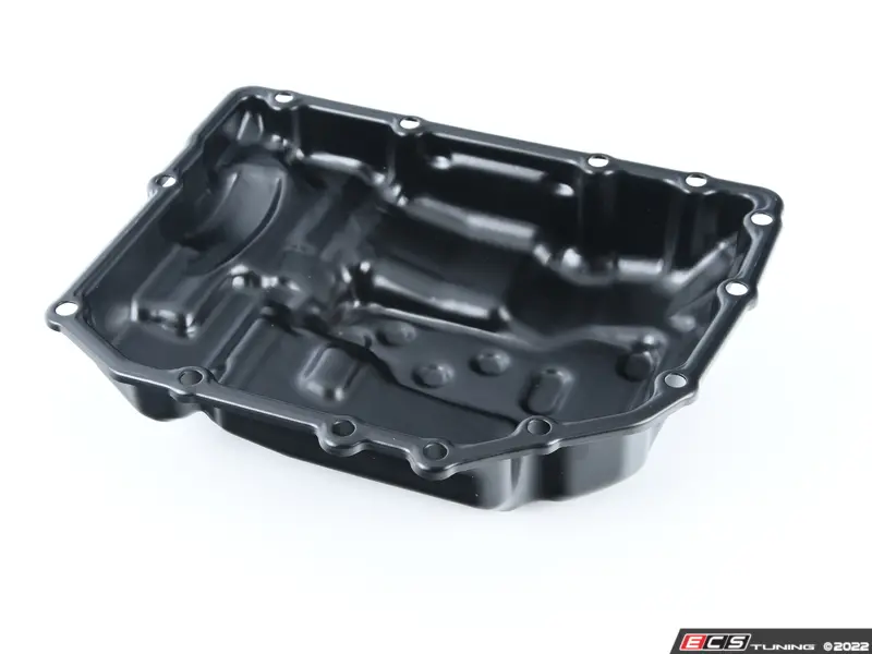

Not much on the newer auto transmissions. You cannot replace much of the internals.
You can get the pan and their is no filter now. We have the pan in aftermarket options. You Just change the fluid.
https://www.ecstuning.com/Search/Sit...h/24118627787/
Transmission Fluid Change:
https://www.northamericanmotoring.co...id-change.html
And parts needed.
