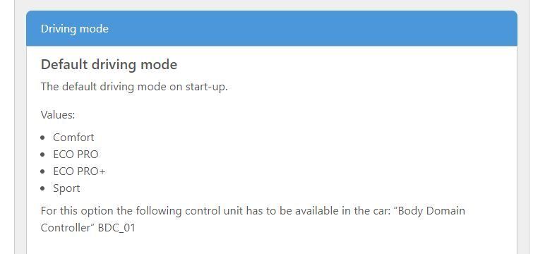

Give it a try, I haven't look for it yet but according to the Bimmercode website it has this;

Sorry, I still test this code on my F54 2019 new UI interface. If you want to try, i can give you the code.
Please code bdc_ecu and open this ''FesHasMode5" to "aktiv". You can turn up the sport button twice to enable sport+.
I have an issue of the sport+ mode, the kombi can't show sport+. Only show on CID.
