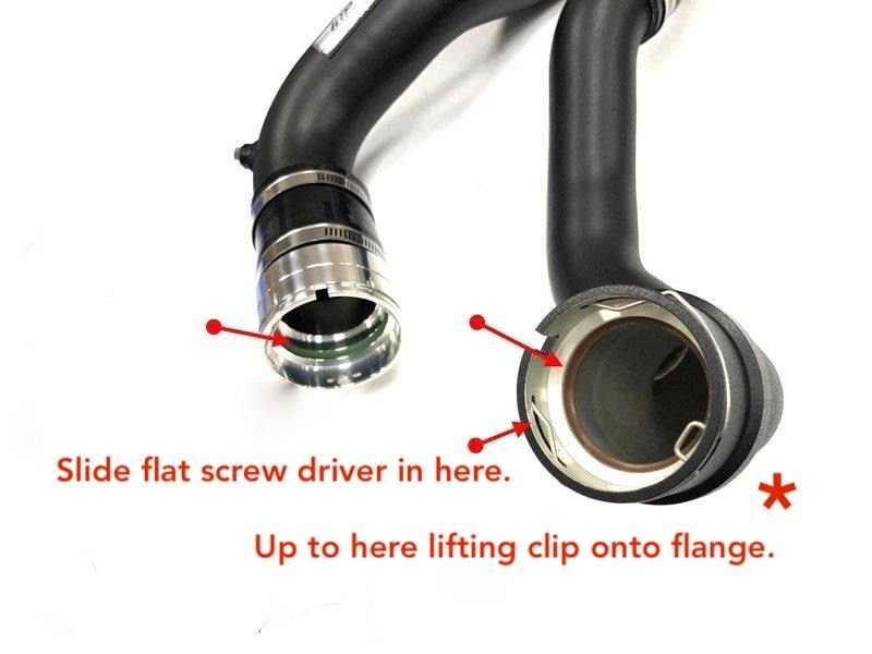

I have found that on the metal clips I focus on getting the square flange tab out of the connector and resting on the flange of the coupler. I know a lot of people work on the two indented spring clip ends. The square spring flange can hang on the coupler tube. If you work it so the square flange can rest on the exterior of the boost connector it is easier to uncouple the pipe. The photo also shows arrows for the seals that you can't forget to reinstall.
