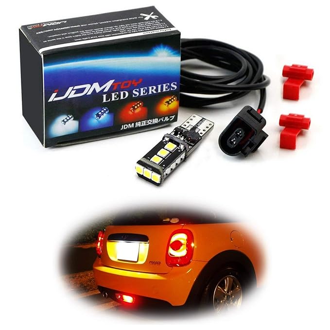

Found this LED fog to brake kit for MINIs on Amazon. Hard wired with LED bulbs. Going to try it.
iJDMTOY LED Rear Fog Lamp Enabling Kit For MINI Cooper R56 R57 R58 F59 F55 F56 F57, Includes (1) 9-SMD 921 W16W LED Replacement Bulb, Rear Foglight Enable Adapter & Wiring Harness
