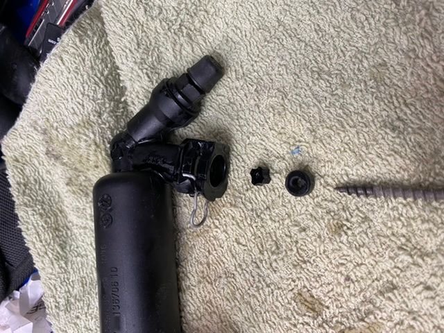

I recently got a F54 Clubman S ALL4 w/manual transmission and felt this terrible 1-2 shift right away. Dump the clutch and floor it after the shift and it’s just a huge clutch slip. Definitely felt like a CDV (clutch delay valve).
I took it apart today, and sure enough. A clutch delay valve is installed within the slave cylinder, just like the F30 BMW. https://f30.bimmerpost.com/forums/sh....php?t=1486773
Tools/Supplies needed:
- 8mm socket (for underbody tray)
- 13mm socket for clutch slave cylinder.
- DOT 4 LV fluid (Found Pentosin DOT 4 LV right on the shelf at AutoZone, surprisingly. And for a good price)
- Something to suck out brake fluid from reservoir
- Ability to bleed clutch system (I use a pressure bleeder)
- Drywall screw, or similar.
- Small pick or flathead screwdriver to remove clutch line clip.
Procedure:
• Raise car. Ramps work fine.
• Remove underbody tray with 8mm socket
• Open hood and Remove lateral cowl gasket. Remove cowl cover - no tools required.
• Clean brake reservoir cap, remove and suck out fluid until level is near clutch supply hose.
• Using a pick, slide metal locking bar off clutch slave connection. Pull away clutch pipe and allow to drip into container.
• Use 13mm socket to remove two 13mm headed bolts holding on clutch slave cylinder. Compress slave piston and remove slave cylinder.
• Gently stick drywall screw into clutch pipe opening. You are screwing into and grabbing a small rubber spacer with a hole in it. Pull out rubber spacer. Turn space upside down and tap on work surface. Black plastic CDV will fall out. Opening is SMALLER than 1.5mm (1/16”) !!
• Reinstall everything and bleed clutch. ** I pressure bled my clutch but it was still dead-limp when I was done. I fixed this by closing the bleed screw, going into the cabin and operating the clutch pedal by hand back and forth aggressively. This started building pressure. I alternated pressure bleeding and operating the clutch by-hand multiple time until it felt normal and all bubbles were gone **
Car drives MUCH better now 👍🏻 Much more direct and consistent clutch engagement. I hated the 1-2 shift because the clutch would engage so slowly and you feel that LOOONG clutch slip.
You could drill out the existing CDV, but I don’t see a need to. Leave it untouched and you can reinstall it if you want.

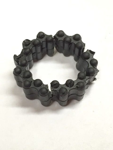

The next step towards better shifting will be filling the sloppy shift cable ends with 2-part urethane. I did it on another car and it worked wonders. I noticed the shift lever ends are “solid”, but the transmission end has one coupling that is terribly sloppy.
From my Ford Focus, below.

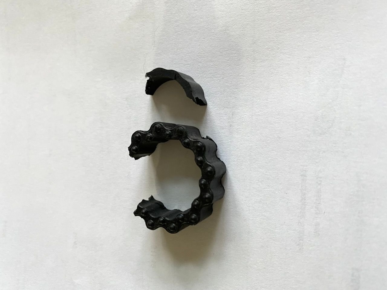

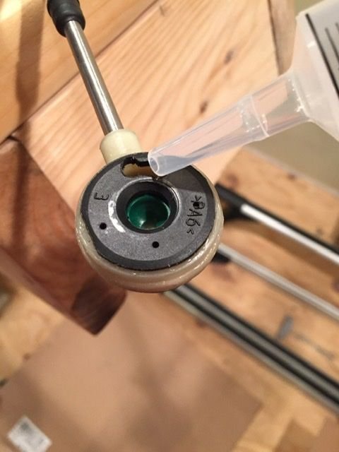

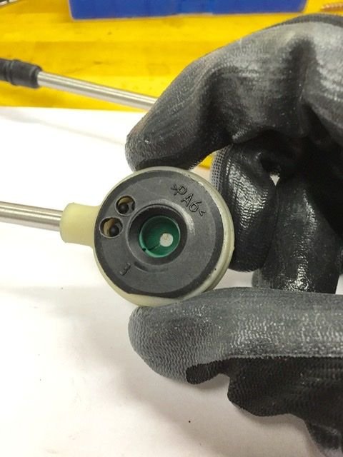

I just filled the shift cable ends in my 2017 Clubman S with 2-part urethane. One was nearly solid rubber, the other was big squishy corrugated rubber, exactly like my 2015 Ford Focus. See post #43. Must be the same manufacturer. I didn’t take pictures because it looked the same. I disconnected the shift cable ends on both the lever and transmission ends and did all the work in the engine compartment. The cable ends at the lever are solid.
Here’s chunks of the two different bushing materials.
Urethane is curing now so I haven’t driven it yet.
