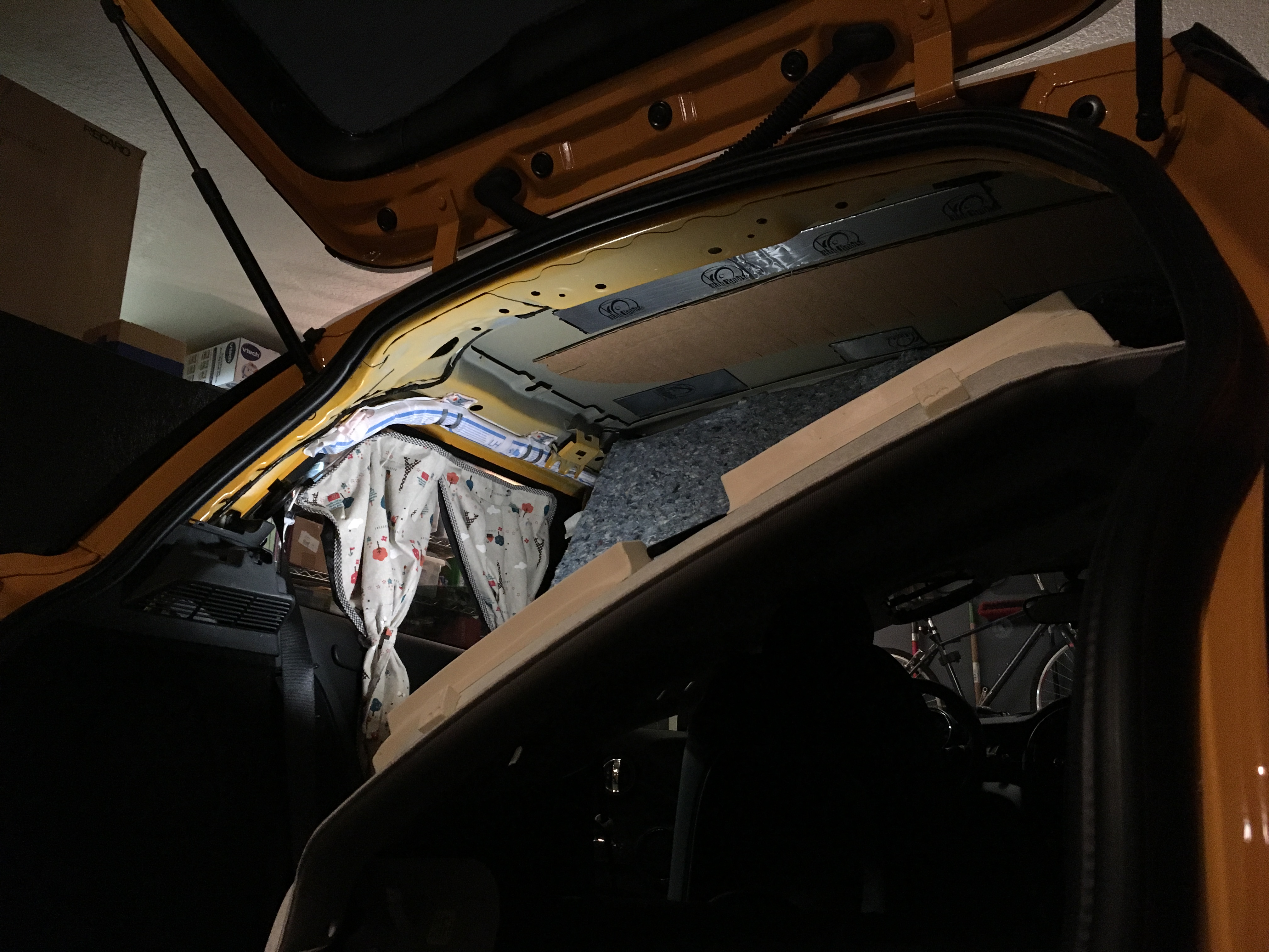

Old Nov 10, 2017 | 11:52 AM
hp79's Avatar
hp79
Joined: Sep 2014
Posts: 520
From: Tigard, OR
I still have MLV and CCF in transport, but I did get the UltraTouch Radiant Barrier so I went to Homedepot and bought 3M 77 Spray glue. I worked on the headliner for about 5 hours straight, trying not to break anything. When I dropped the headliner, it was a shock when I saw there's actual card-board mounted on the ceiling. I only took picture of the cardboard after placing a few butyl-aluminum backed vibration dampers. After that I cut the radiant barrier to fit front and back, and also some more extra to make up for the dead space. It was a very time consuming job. After everything, my roof now feels much more dense and no more egg crate feel from the headliner. I didn't take any picture, and didn't do any measurement on noise. The car is parked in the garage and I'll probably drive it once I'm done with doing the floors, sides, and doors with CCF+MLV and extra radiant barrier where applicable. Worst case, I will end up with much less rattles in the car since I'm also looking everywhere for possible rattles while panels are out.
