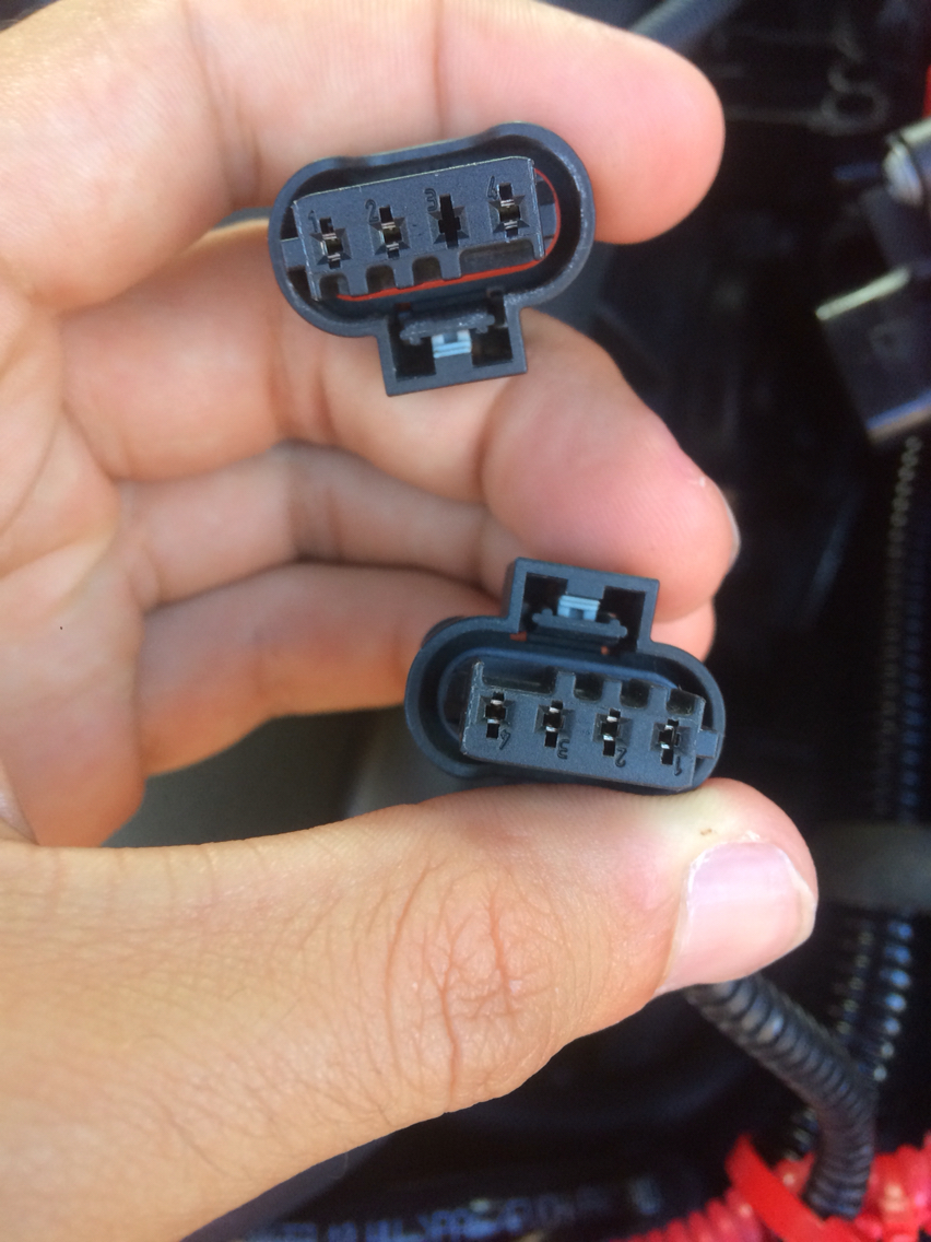

Could this be the culprit? The top is the MAF sensor electrical connector from my car and the bottom is from the stage 1 bms piggy back. I think the top one is missing one of the peg clips? Not sure though.

i didn't think the BMS had a MAF plug. thought it was only MAP and T-MAP for Stage1, and fuelrail added on for JB4.

Does it not plug into the MAF? I thought it did... I'll double check. I'm on the original firmware and never updated it and never got and CELs before. I took it off for some dealer work and put it back on and I think I messed something up.

nah. the MAF plugs into the intake. The stage1 plugs into the MAP and T-MAP Sensors. both are in front of the car on passenger and driver side.

HAHAHAHAHAH just read the instructions! I'm so dumb. I can't believe I did that. Thanks for pointing that out.... Anyways I still got the CEL codes after removing the stage 1 which is a problem I'm still trying to diagnose. Thanks Marco!
