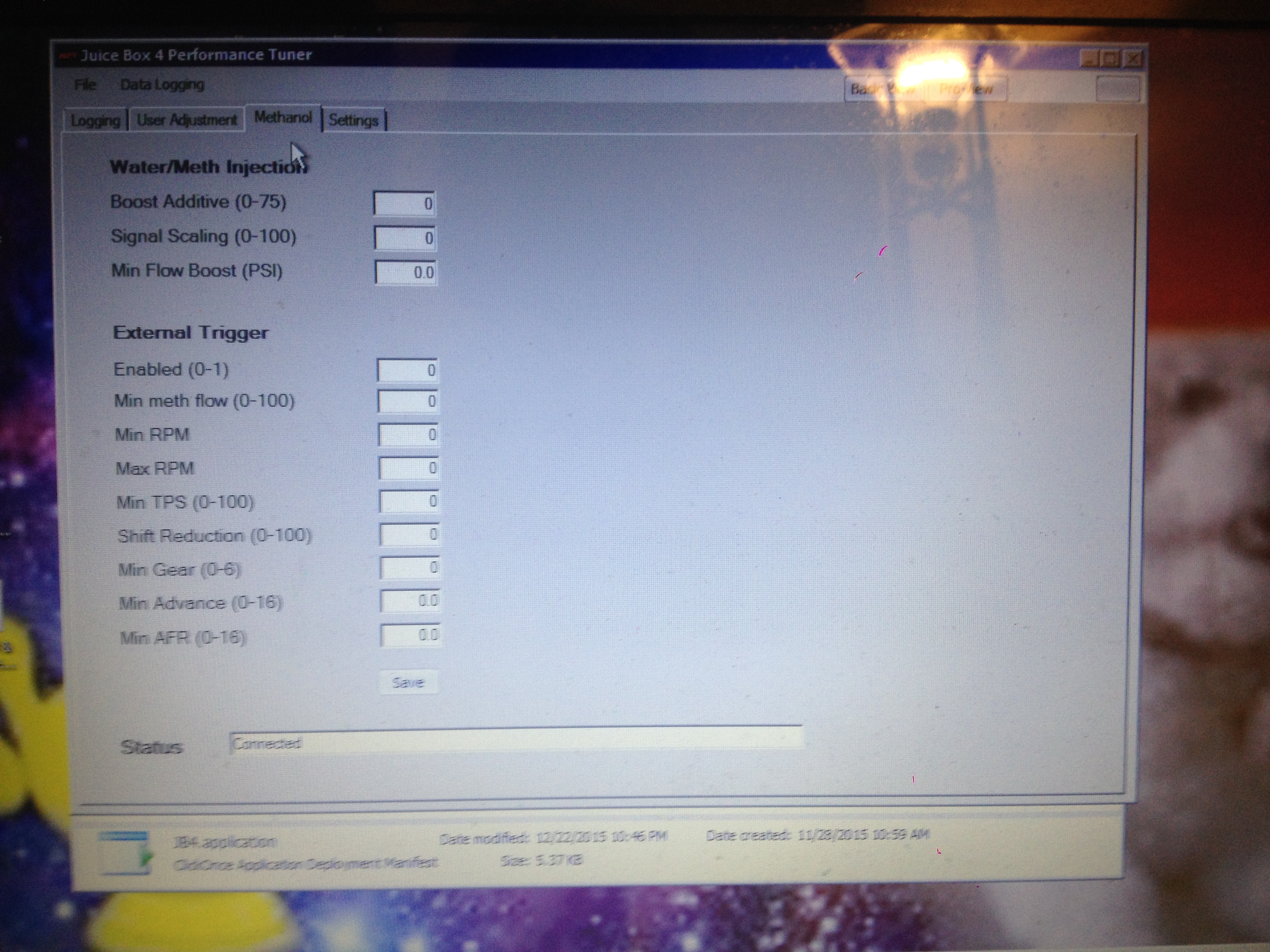

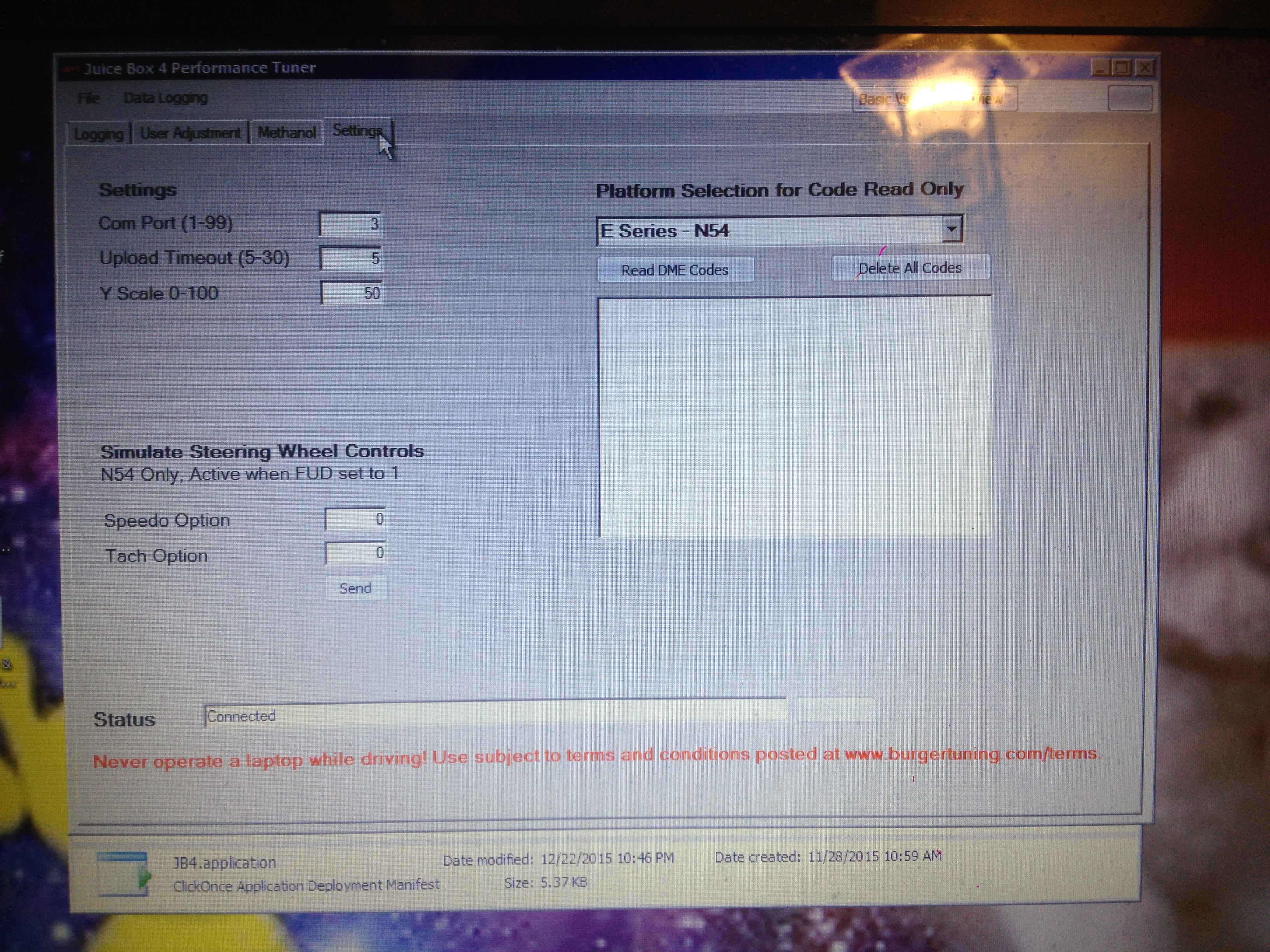

What are the stock user settings for the Stage 1 Beta?
When I adjust the user settings and click "save" I get the "settings saved!" message but the display boxes revert back to the old settings.
Can someone point me in the right direction? I don't know what to do anymore.
This is what I'm seeing and I don't know what to do. I'm totally lost and nothing is working, having computer troubles as well so frustration levels are high.
Attached Thumbnails HELP!!! BMS Stage 1 w/ data cable-img_2642.jpg   HELP!!! BMS Stage 1 w/ data cable-img_2643.jpg   HELP!!! BMS Stage 1 w/ data cable-img_2644.jpg   HELP!!! BMS Stage 1 w/ data cable-img_2645.jpg
