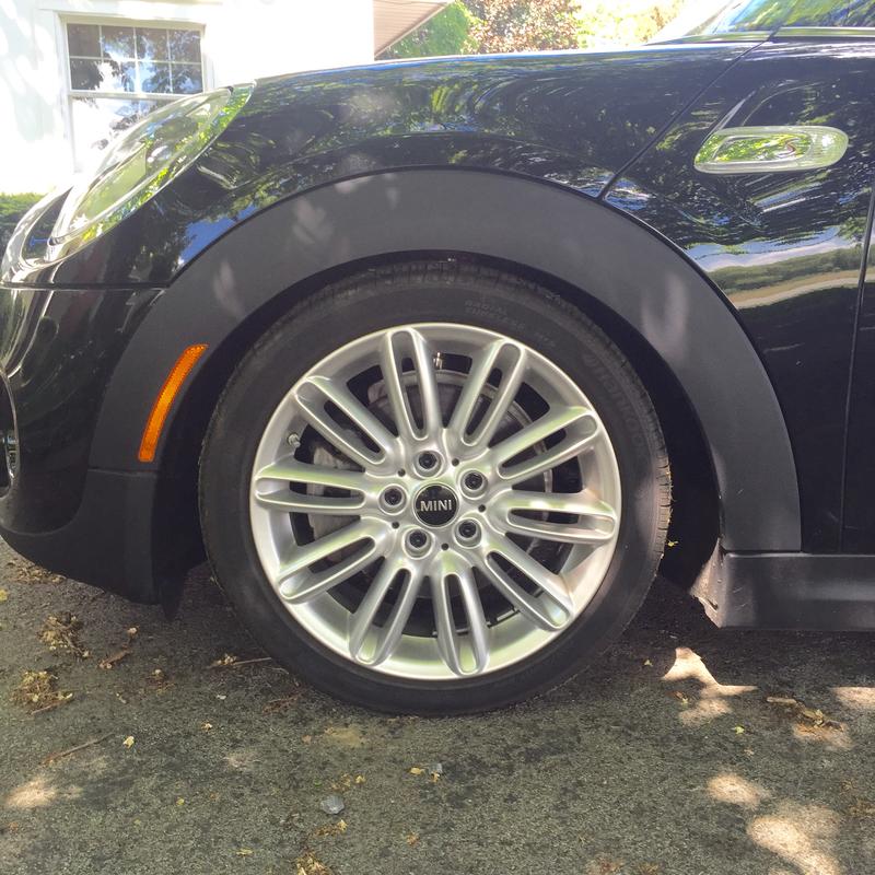

Hello everyone.
So, last week I had my KW's installed on my MCS and just wanted to share that they are great! Very happy with the look and the way they feel on the road.
If you're considering coilovers, I highly recommend!
Took it in to the MINI dealer for alignment and camber in the front is -0.5 degrees and the rear is -2.0 degrees.
Also, at this height, I've had no problems with bottoming out anywhere...like in/out of driveways, speed bumps, etc...
happy motoring!
Attached Thumbnails KW V1 Coilovers installed = love!-fullsizerender-2.jpg   KW V1 Coilovers installed = love!-img_6141.jpg   KW V1 Coilovers installed = love!-fullsizerender.jpg

Are you glad you went for them over the JCW Pro "coilovers"?
The KW's are great aren't they!

Did you happen to take any stroke and bumpstops measurements to determine where to put the ride height, and also how they compare in stroke versus stock?
If not, did you measure your ride height change (and at what spring collar positions), front and rear?

With the JCW kit, you can only lower the car by 20mm max which is only 0.787 of an inch.
