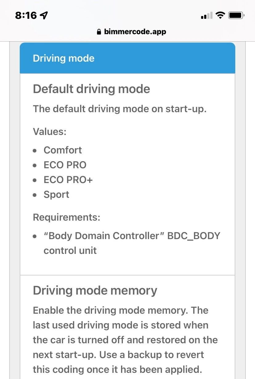

The "S" mode increases engine responsiveness in addition to the sportier shift points. To me this is almost the ideal setting.
consider setting driving mode memory instead. It will remember sport mode when you set it, but if you decide to drop out of sport you won’t have to disable it every time you start the car.
