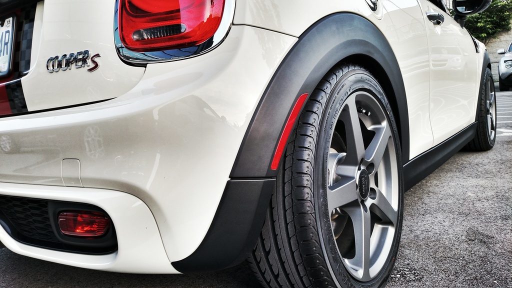

I am going to probably be in the minority but I even upgraded wheels/tires and stayed with runflats. Very happy with both the Oem Dunlop's and my new Yokohama's. On my r57 I changed them immediately. I am also on NM springs and still rides great.
