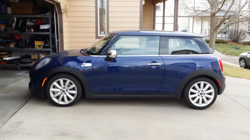

Well, it's that time. Might as well post up the pictures. Here's the MINI all ready for winter.

Nice! Just had mine installed yesterday just in time for the snow. It's nice to be able to drive with confidence 😊 I'll take some photo and post next time.

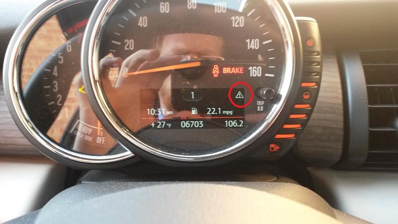

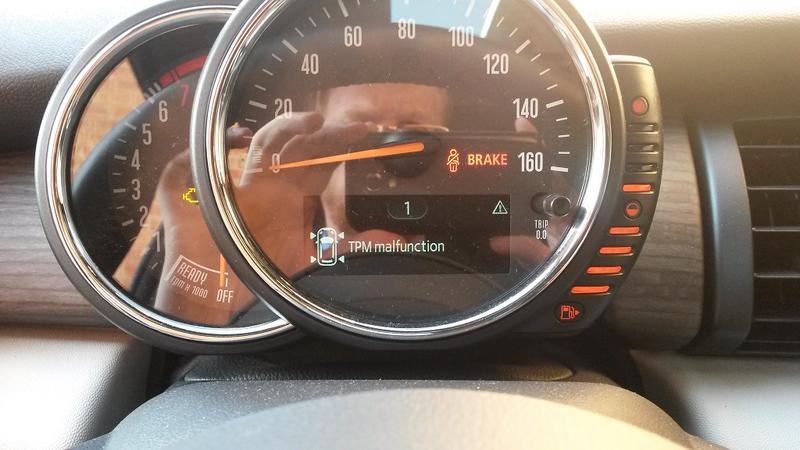

For those of you who are curious, I am running winters without TPMS sensors. Once the car realizes there is a "malfunction", a message is displayed on the Nav screen and the OBC. Additionally, there will be an illuminated TPMS light in the instrument cluster. You will then get these messages each time you start the car. Both messages can be cleared. The TPMS light will flash for ~30 seconds and then remain illuminated. There will also be a Check Control warning in the upper right-hand corner of the OBC. It's relatively unobtrusive and you learn to ignore the light.

Also, for those considering not using TPMS, the warning monopolizes your on-board computer display, which is a non-starter for me. I'm not going to go through the whole winter without being able to obsessively monitor my fuel mileage or total miles per tank.
That is 100% not true. The warning message takes over the screen when you first start the car. However, pushing the button on the end of the turn signal stalk clears the message. The only thing you're left with is the triangle Check Control sign in the very upper right hand corner. No functionality is lost. See attached photos.

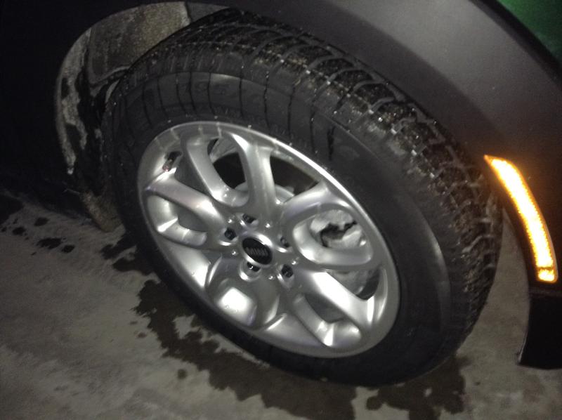

My winter wheels are Pirelli Snowcontrol Series 3 Runflat 195/55R16 on loop spoke wheels.

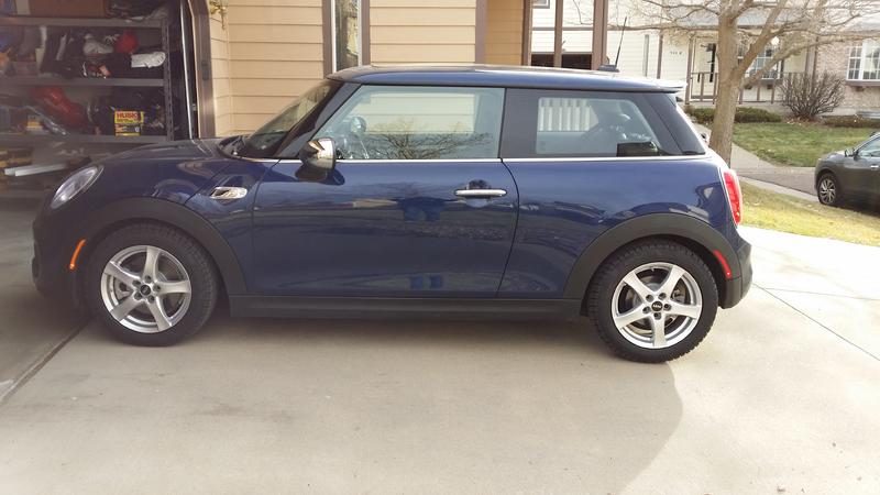

Finally had a chance to take a photo after busy weeks. I went with 195/55R-16 Dunlop Winter Maxx XL with Anzio Vision for my winter package. I went 1 inch smaller than my summer tires for improved performance in snow.
I had a chance to take it out on a snow few weeks ago and it went through a pile of snow in front of my drive way with ease (while my neighbor couldn’t clear and had to get out of the car to shovel haha). I wasn’t crazy about the wheels in the beginning but it kind of grew on me and I’m happy with the way it looks now. I got the TPMS because I just like to see the tire PSI on my infortainment system so I can check everyday and drive with peace knowing that it’s properly inflated. To each his (her) own

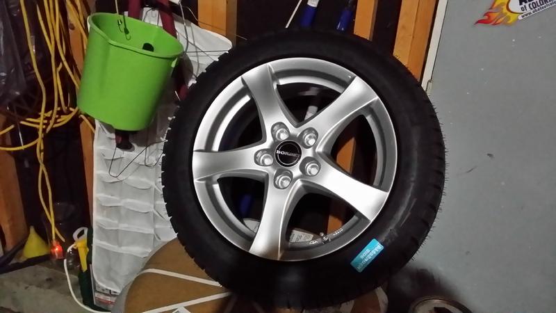

I purchased a winter tire and wheel package from TireRack.com. I went with the 16x6.5 Borbet Type F Bright Silver wheel from Germany and the 195/55R-16 Michelin Primacy Alpin PA3 ZP Run Flats. I also sprung for the 433Mhz TPMS.
Tirerack mounts the tires on the wheels, installs a centering ring and TPMS then balances them. Each wheel and tire combo is shipped separately with foam padding and cardboard to protect the new wheels. They do not come in a box.
I installed the new winter package using a 17mm deep well impact socket. As a reminder, when removing the summer wheels be sure to have the car supported by a jack first before you remove the bolts. Yes, the wheels are held on by 28MM M-14 1.25 wheel bolts, NOT LUG NUTS. If you pull all the bolts out without supporting the car first you could damage the break components as the car could tip and ram the rotors into the ground.
The torque spec for the wheel bolts is 101 foot pounds. Also, The wheels are shipped with about 30psi in the tires so I upped the fronts to 41psi and the rears to 38psi per spec in the owners manual. Because I have the MCS model the smallest wheel you can install is 16 inches (you have more winter tire options if you go with a 16 inch wheel BTW). It leaves about a finger width gap between to break caliper and the inside of the wheel.
The Michelins are really quiet and super grippy. The ride is actually a little nicer than the 17's. The cool thing about the Borbet wheels is that you can swap out the stock center caps with the Mini logo ones so it looks like it came from the factory.
