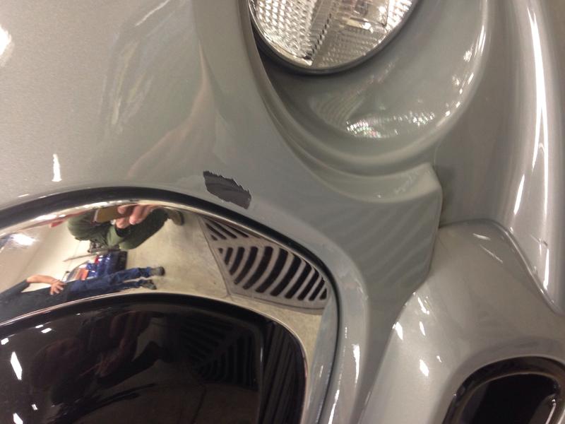

Old Aug 24, 2014 | 08:06 PM
Slilock's Avatar
Slilock
Joined: Aug 2014
Posts: 33
From: Spokane, WA
Here's some pics.
Old Aug 24, 2014 | 10:03 PM
TouchUpDirect's Avatar
TouchUpDirect
Joined: May 2014
Posts: 91
From: Los Angeles
Originally Posted by Slilock
Here's some pics.
Aw man, that's a drag. That's one of the problems with lighter colors, the black plastic shows through whenever there is a chip or damage. Although I do love your color, a lot.
Anyway, I'm thinking that it started from a rock or some sort of debris from a vehicle in front of you. Then it likely spread to the size you see now. I doubt it's a factory defect but you could certainly run it past your service department at the dealership.
Otherwise touch it up and you'll not notice it anymore. You'll be able to find it yourself, of course, but the average person looking at the car will never see it in a million years.
Old Aug 24, 2014 | 10:08 PM
Slilock's Avatar
Slilock
Joined: Aug 2014
Posts: 33
From: Spokane, WA
I just find it odd that it was right where the clear bra is. I think the clear bra installation may have had something to do with it. The Mini dealer is four hours away, if it's a paint defect from the factory they can tow it to them. Car only has 800 miles on it.
Old Aug 24, 2014 | 10:10 PM
TouchUpDirect
Joined: May 2014
Posts: 91
From: Los Angeles
Ahh, I didn't realize a clearbra is involved here. That's a big difference. Did the paint flake off under the clear bra and both came off at once?? Or is it not where the bra covered?
Old Aug 24, 2014 | 10:32 PM
Slilock's Avatar
Slilock
Joined: Aug 2014
Posts: 33
From: Spokane, WA
It flaked off right where the clear bra stops. The paint is fine under the bra.
Old Aug 25, 2014 | 02:36 AM
Sketch's Avatar
Sketch
iTrader: (12)
Joined: Aug 2008
Posts: 1,042
From: Las Vegas, Nevada
I read about an F56 owner in UK who noticed problems with his MINI's front bumper paint. I think it was something to do with the clearcoat coat. The dealership blamed spotty paintwork at port and had the bumper repainted.
When washing, did you use a high pressure sprayer? Possible the nozzle came too to that area and tore the paint off?

Old Aug 25, 2014 | 07:52 AM
Nuke-em's Avatar
Nuke-em
Joined: May 2014
Posts: 168
From: Chicago, IL
That seems unusual. Paint will usually chip off when struck by a rock; that's peeling paint. Paint has flex additives in it so plastic parts (like bumpers) can sustain movement without cracking and flaking off. If this went all the way to the plastic, I would think that the part was not prepped correctly.

Old Aug 25, 2014 | 08:27 PM
Slilock's Avatar
Slilock
Joined: Aug 2014
Posts: 33
From: Spokane, WA
Took it to the auto trim place, they looked at the paint and said it looked like it was a poor factory paint job due to the fact the paint looks like it barely bonded with the bumper plastic. They're having the bra taken off, repainted, and then reapplied 30-days later.
Old Aug 25, 2014 | 08:40 PM
Benibiker's Avatar
Benibiker
Joined: Dec 2007
Posts: 2,283
Likes: 37
From: Honolulu Hawaii
Maybe the clear bra installer used a razor blade or other sharp instrument right along the edge and that caused the paint to peel.
Old Aug 25, 2014 | 10:38 PM
Slilock's Avatar
Slilock
Joined: Aug 2014
Posts: 33
From: Spokane, WA
These guys have been installing bra's on my vehicles since 2008. They're awesome. Also I've hear of some flaking paint in other 2014's, and just by looking at the paint you can tell it wasn't bonded to the bumper properly.

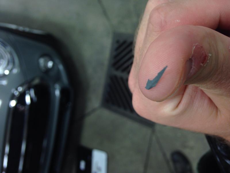

Old Aug 26, 2014 | 08:43 AM
Slilock's Avatar
Slilock
Joined: Aug 2014
Posts: 33
From: Spokane, WA
Peeled the two week old bra to reveal how bad the paint is.
Old Aug 26, 2014 | 08:45 AM
Slilock's Avatar
Slilock
Joined: Aug 2014
Posts: 33
From: Spokane, WA
Another
Old Aug 26, 2014 | 09:22 AM
TouchUpDirect
Joined: May 2014
Posts: 91
From: Los Angeles
Dang, yeah I'm sure you've got a good case there with BMW...that's pretty obviously a defect.
Old Sep 5, 2014 | 08:37 PM
Slilock's Avatar
Slilock
Joined: Aug 2014
Posts: 33
From: Spokane, WA
Got the car back today. Did a outstanding job repainting it. Now in talks with Mini to get the money back to the trim place who paid for the repaint.
