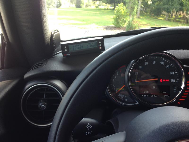

Papa - Can you post pics of the gauge setup in your car? Would love to see how and where you mounted them
Just velcro'd it to the dash. Set back just enough so the steering wheel doesn't block my vision. Routed the cable out the back and down the door jamb area to the connector below.
Attachment 97979
Does the job. Thanks for posting.
