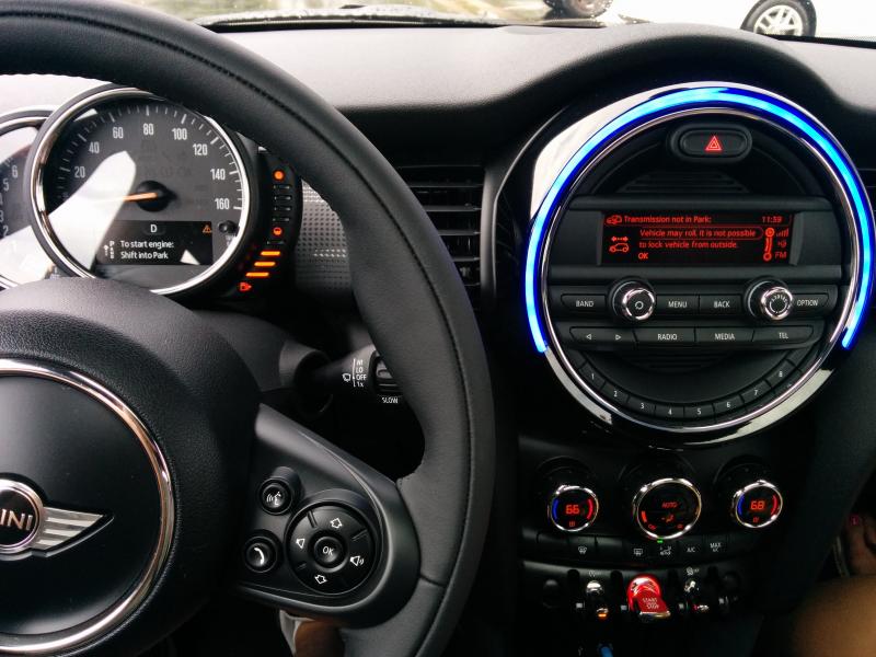

Happened to me the second time yesterday. I was lucky enough to take some photos as I was the only one in the parking lot.
The center instrument message showed "Transmission not in Park: Vehicle may roll. It is not possible to lock vehicle from outside."
The odometer display showed "To start engine: Shift into Park"
You can reproduce the exact same mesage by leaving the transmission in Drive and shuts off the engine manually if you didn't get a chance to take a photo. The computer doesn't record this code as it probably thinks it's human error.
I am taking my car to the dealership this Friday. Over the phone it didn't sound like they were aware of this issue. I hope they won't solve this by simply do some idle adjustments.
