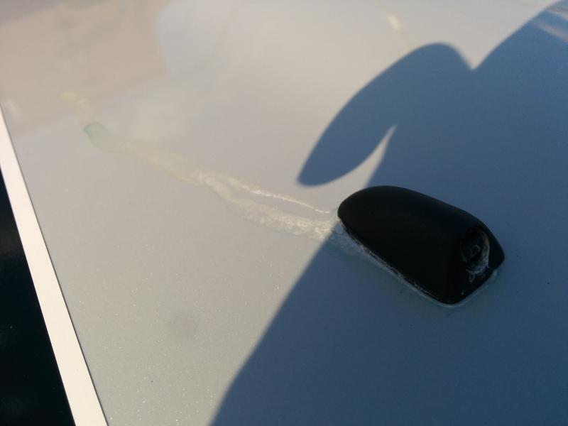

Back at the dealership this morning.. Drivers side nozzle is weeping again after it was repaired the first time.. Stay tuned

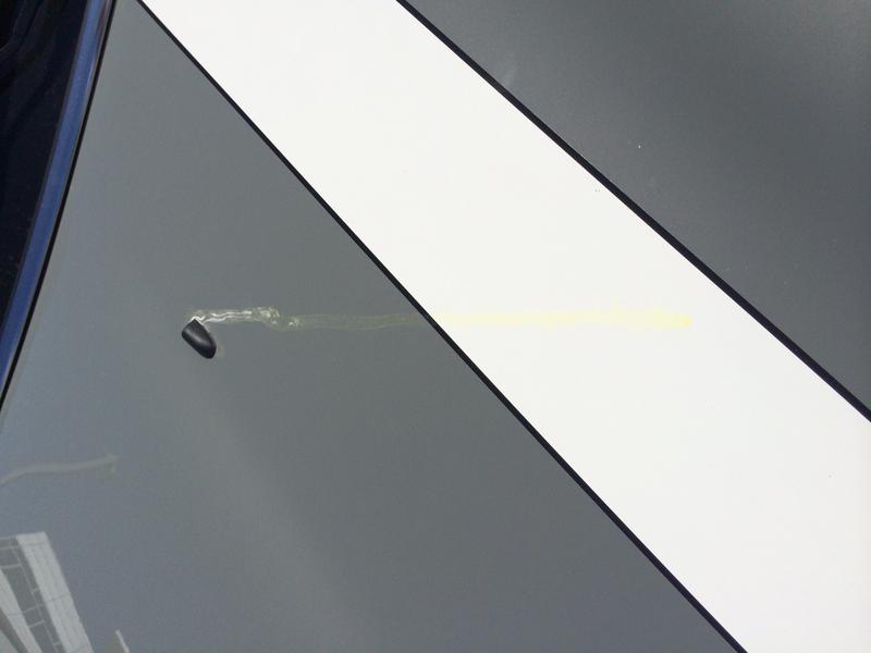

It's not my car, mine hasn't leaked yet, but I saw this in the parking lot at work. First other new Mini I've seen up close, and what's the first thing I see but a weeping duct. Wow, that fluid does look disgusting! It's ruining that stripe too. What is this stuff??
