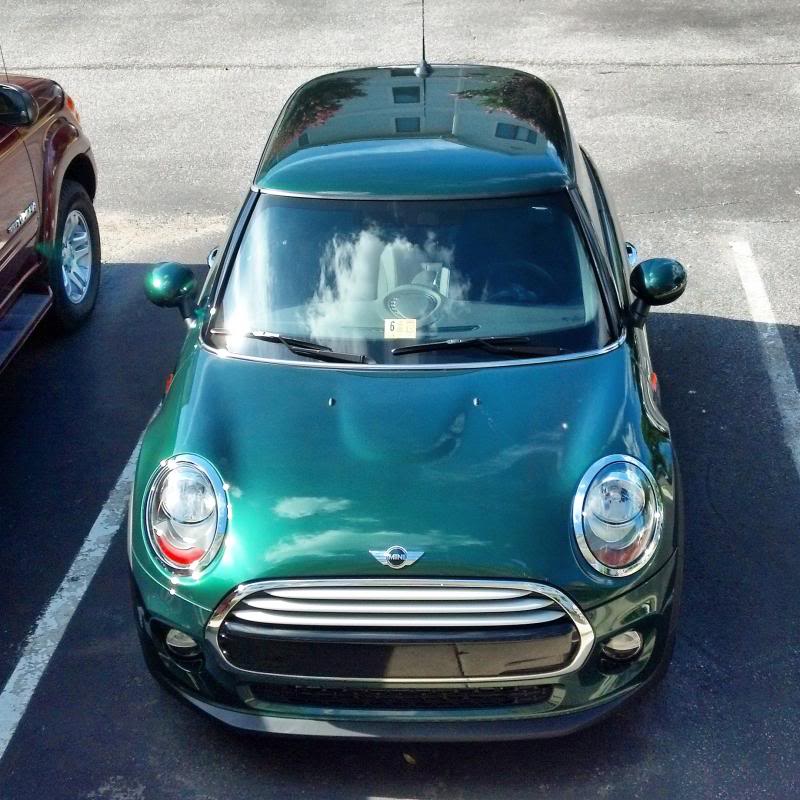

Sad to say, mine does this too. Picked it up this morning fully "cleaned" and ready for delivery. By the time I got it home, I had a trail of residue from the driver side nozzle.
I just noticed that in your picture bluvw69.
Otherwise your car looks like I hope mine does.
Oh? Twins! Since that first day, I've kept a bottle of spray detailer and a microfiber towel in the boot. Happy to report though, that this has not been an ongoing issue.
