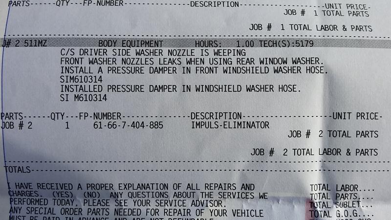

here is what mine repair order said
Old Aug 1, 2014 | 07:03 AM
  #87
russmini's Avatar
russmini
Joined: Jun 2008
Posts: 457
Likes: 10
From: Northern California
Thanks. My service manager asked if my front nozzle leaked after using the rear. It doesn't. Sounds like a valve problem though.
Old Aug 1, 2014 | 07:07 AM
  #88
Posts: 36,758
Likes: 2,548
Looks like a called it correct a couple pages back
"" 07-18-2014 12:12 PM
Here is the part called the Impuls-Eliminator. Thinking that's is the check valve for both those lines, check under your hood, is there one only one side. or one before both ? Not there at all ?
#3 Part # 61667404885
http://www.ecstuning.com/Search/SiteSearch/61667404885/ES2745229/
Click the image to open in full size.
This looks like the check valve for the F56.

The repair order calls it 1 hour labor. Even if this is rounded up, can you imagine the waste of money making dealers all over--presumably the world--fix something that could/should have been done on the assembly line.
Plus damage to paint and stripes, of course.
Just the hit to the J.D. Powers surveys should be enough--you know, the one where you have to report how many times your car's been in the shop?

My repair order done today states: Replaced drivers washer jet and installed 2 non return valves for front washer jets.
