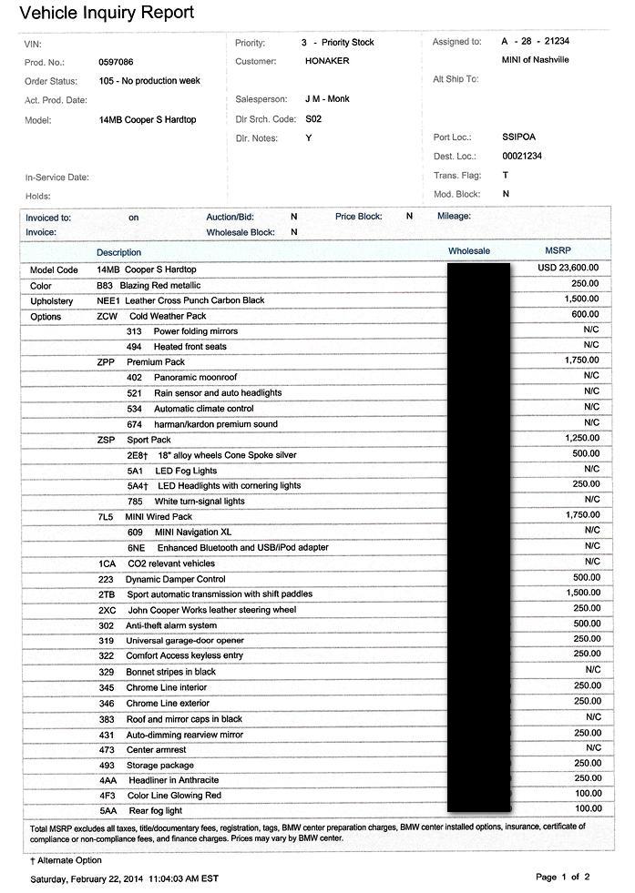

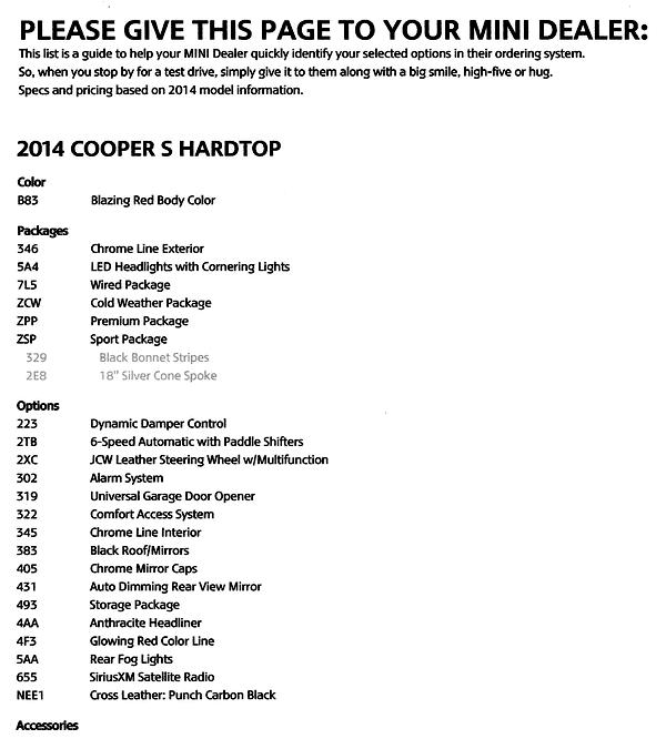

Hi Bob,
Look at #223 ... Dynamic Damper Control below.
And also below as an Option for $500.00 dollars
T.
