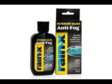

Try putting Rain-X Anti-Fog on your windows to see if that makes a difference. I've used it with success before.

+1 on the ac, you might also nee the clean the front windshield on the inside, they can get a film on them and when you get a fog buildup its worse. The rain X Anti fog works somewhat but you have to keep redoing it.
