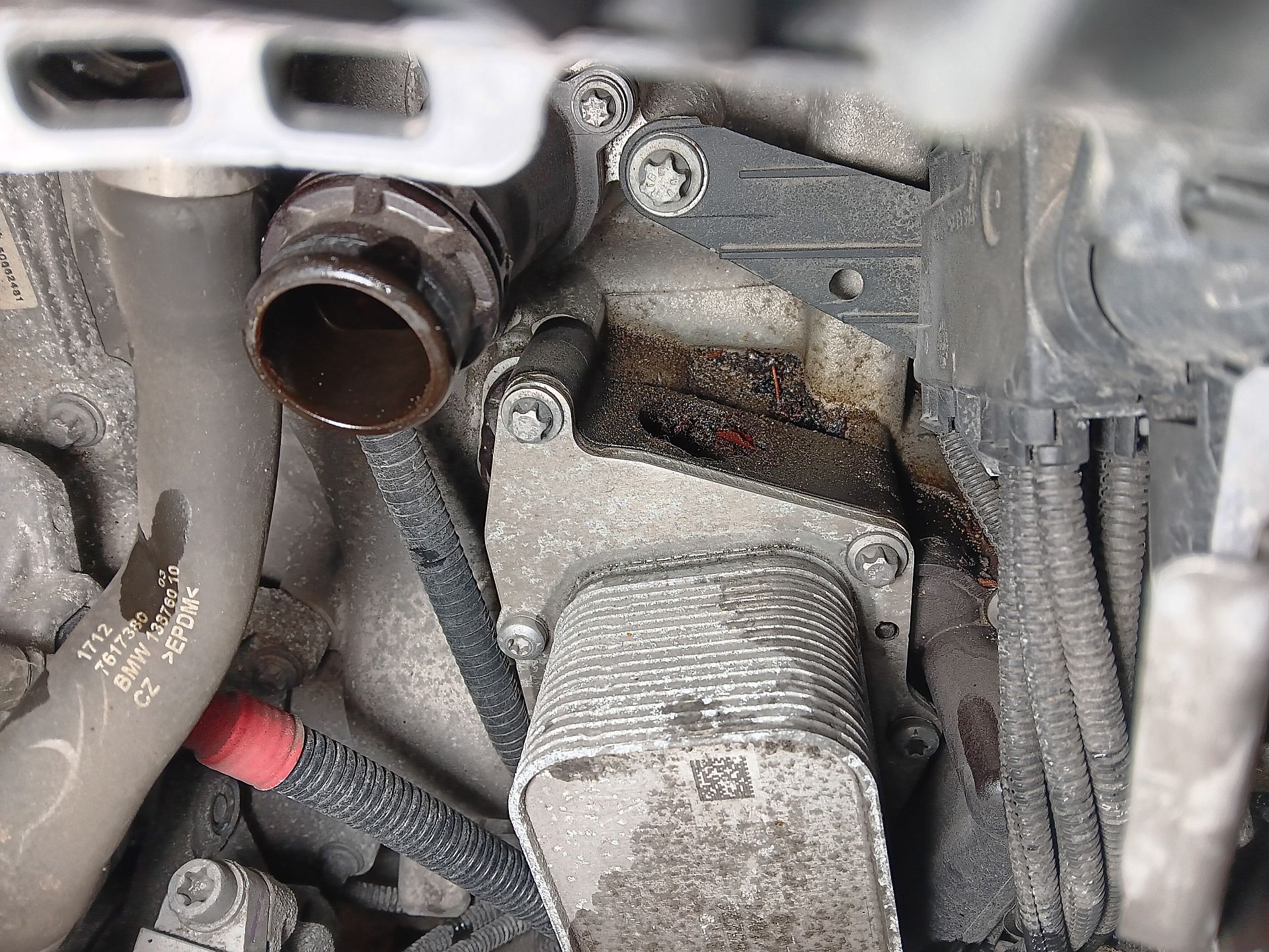

Well, my oil cooler finally gave out on me. Even though I have been very slowly losing coolant over the past few years, I could not find any evidence of an oil cooler leak on the underside of my engine or oil filter housing. I am guessing it was small enough to evaporate off the block before running down and making itself evident from below.
All that changed a couple weekends ago, where I lost all heat out of the vents over ~2 mile drive, so I turned the car around and headed back to my house. Glad I did, since that was the point the oil cooler ‘let loose’ and dumped most of my coolant along with a small amount of engine oil. I parked my car in my garage and ran my errands with my wife’s Wrangler. When I came back I was greeted with a nice puddle of coolant/oil mix on the garage floor along with a soaked belly pan.
So I got the car up on jack stands and pulled the belly pan to confirm the suspected failure. Yep, now I had plenty of evidence of an oil cooler housing failure, no doubt. Uugghh, now onto the interwebs to do some detail reading, ordering up some parts and reserving a rental car, since this is my daily driver.

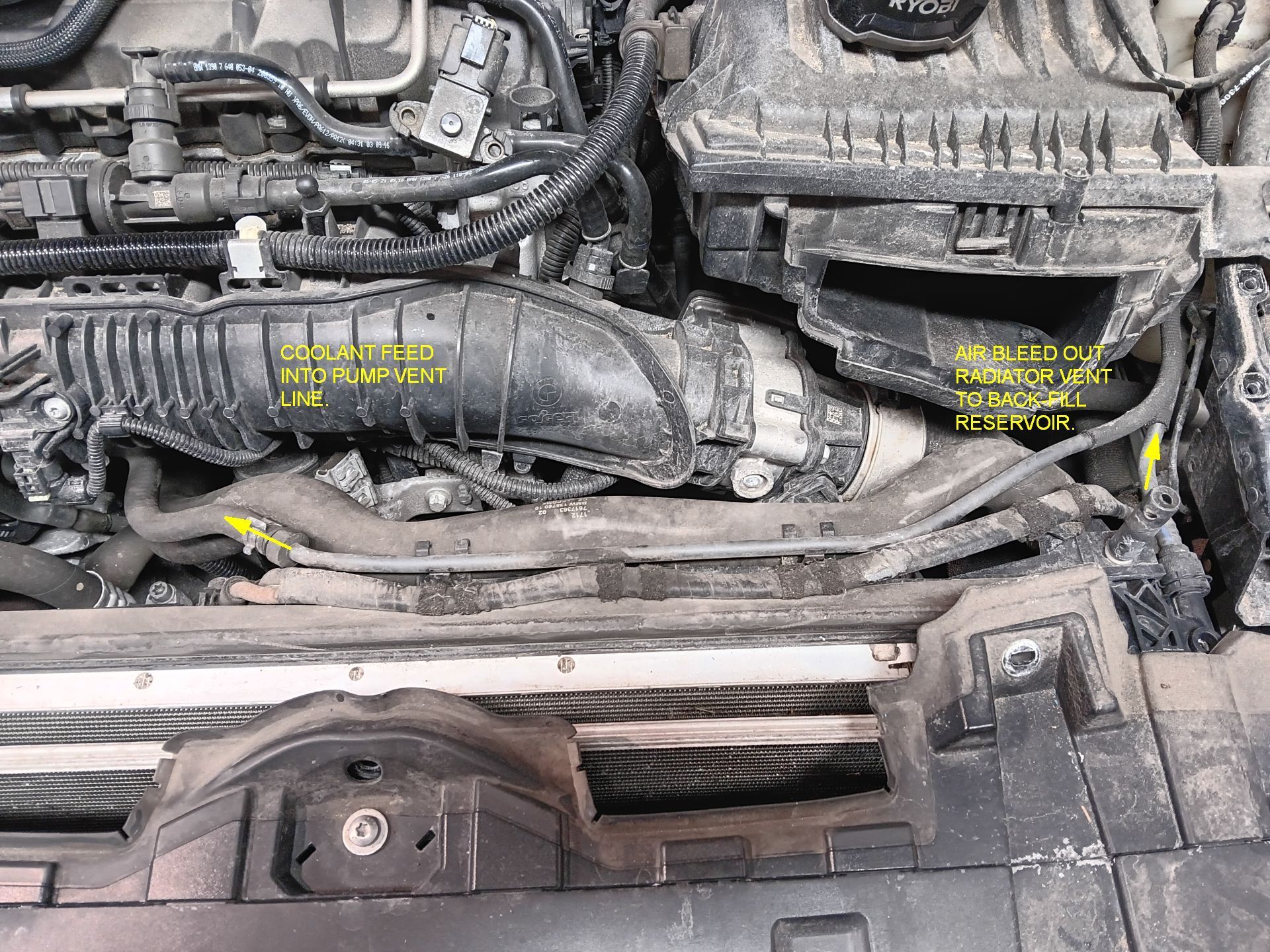

All in all it was not a difficult repair, IMHO, but having worked on my own cars for ~40 years may have something to do with it. It was easier than changing the timing belt/water pump on my former Subaru 2.5L. A couple of takeaways from the project: 1) You DO NOT have to pull apart/remove everything that the manuals describe, so long as you take your time removing/installing the fan assembly and oil cooler, 2) Removing the auxiliary water pump IS necessary and 3) You can pressure fill the coolant with a Mityvac MV8500 Silverline kit through the coolant pump air bleed line (see below).
I had only ever used my Mityvac kit for bleeding brakes, never to pressure fill something, but it worked great. Two engine air bleeding passes and my coolant has been steady for the past 4 days of driving.

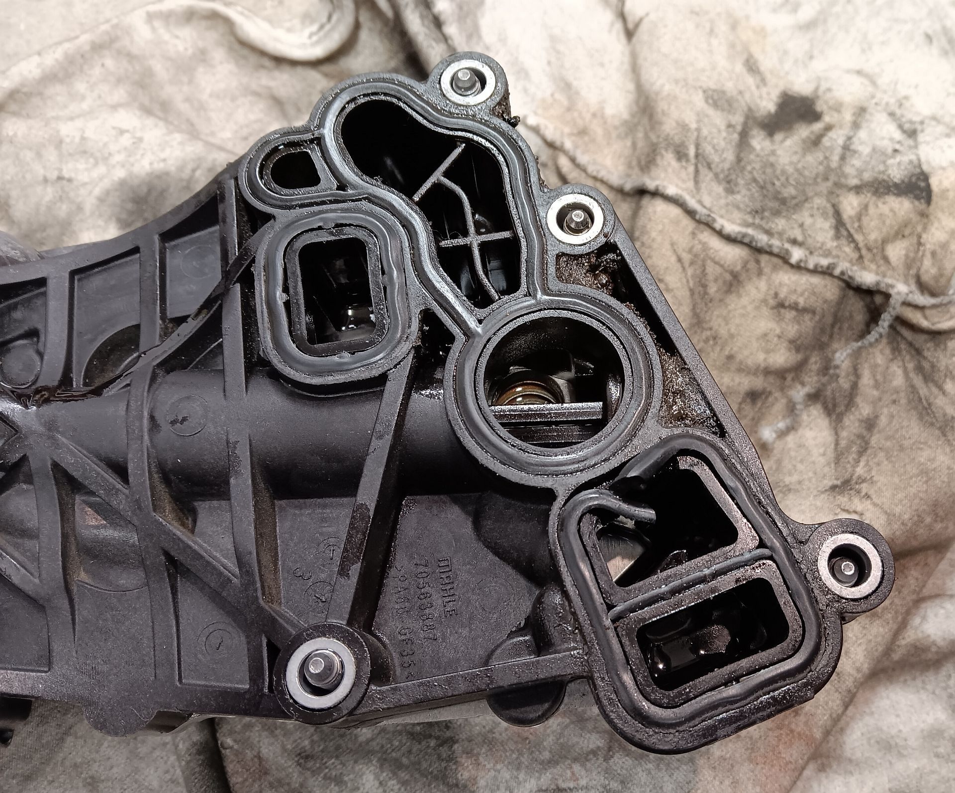

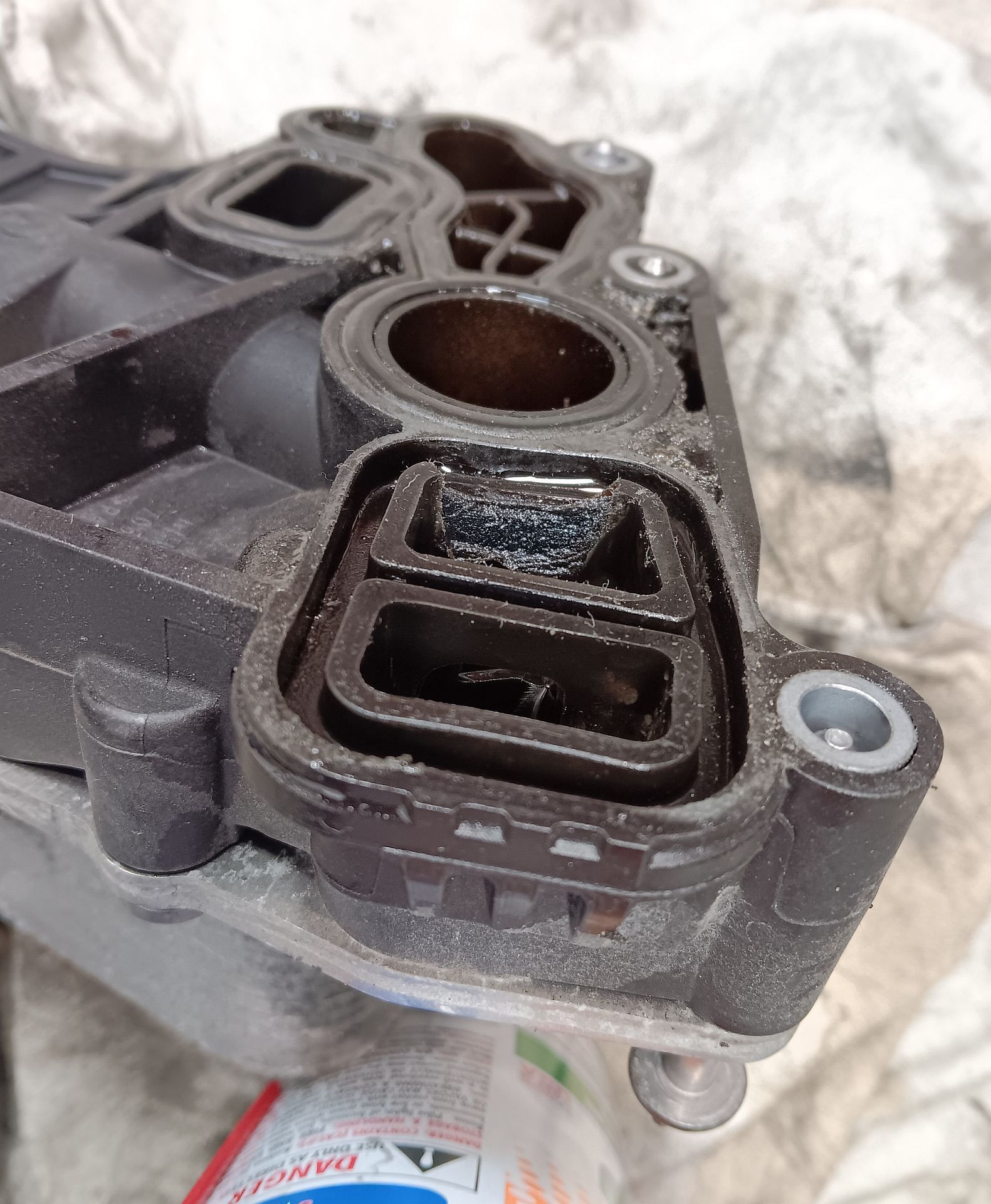

I would also like to note another couple of interesting anomalies I ran into. Specifically with the tightening of the oil cooler housing to the block. First was one of the supplied screws in the Bremmen unit would not freely run down into any of the block threads, regardless of which position. It would bind up slightly a couple of turns in and be require a tool to run it down into the thread. I ended up reusing one of the OEM housing screws that would freely run down into the block by hand w/o a tool. Second was that the housing exhibited a significant ‘relaxing’ of the gasket, that I feel anyone installing a new oil cooler has to pay very particular attention to. I installed the cooler and torqued down the housing in the recommended torque sequence with a torque wrench to the specified 10 Nm. I decided to call it a night at that point and come back to finish putting everything together the next morning. When I returned, I decided to go back over the screws with the torque wrench just to check. Well, the #1 screw on the top-level position greeted me with ~1/2 turn before clicking at the 10 Nm setting!?! I followed the tightening sequence around the remaining (4) screws and did not get even 1/16th of movement from any of them…very interesting. I let it sit for ~2 hours and went back over all of the screws. This time I didn’t see any movement out of all (5) screws. That #1 screw is closest to where the housing fails and I am wondering if there is an unanticipated joint relaxation with the gasket on this housing design, which may contribute to said housing failure? Not sure just what kind of tightening strategy they use on the production line, but it may not be able to compensate for what I encountered. In any case, I strongly suggest letting the housing sit a good 4+ hours after tightening down the mounting screws and going back over all of them before putting everything back together.

Well, the OEM part did last ~8 years and ~90K miles, so the Bremmen part should last well into the future. The fact that the Bremmen gasket/o-ring seal relaxes that amount is concerning in my mind for anyone else putting one it. If the housing isn't properly seated against the block and all sealing is relying on just the gasket/o-ring wall, I can see an early failure for these units.
I happen to work in Mfg and have dealt with fasteners/coatings for ~25 years. Short of bringing the screw to work and running a thread gage on it, it didn't show any excessive coating thickness, so I put it down to just a 'bad' fastener form. BTW, gaging of screw threads typically uses one tolerance range pre-coat and another post-coat depending on the coating. As for slag/dirt getting into that thread, it was one of the first things I looked at. There was some debris in that particular hole, which I cleaned out with some brake cleaner and a thread restorer tap. That did help the original screw hand thread into the hole, but that supplied screw on the Bremmen part wouldn't go into any hole w/o resistance, so it went into the recycling bin.

Quick update ~2 months & 2,000 miles into the OFH replacement. No funny smells or evidence of any leaking anywhere I can see. My bleeding method of pumping it into the main water pump vent line, in conjunction with the factory coolant bleed cycle/method seems to have worked like a charm. Only 1 addition of 2oz of coolant in the first week and holding nice and steady since.
