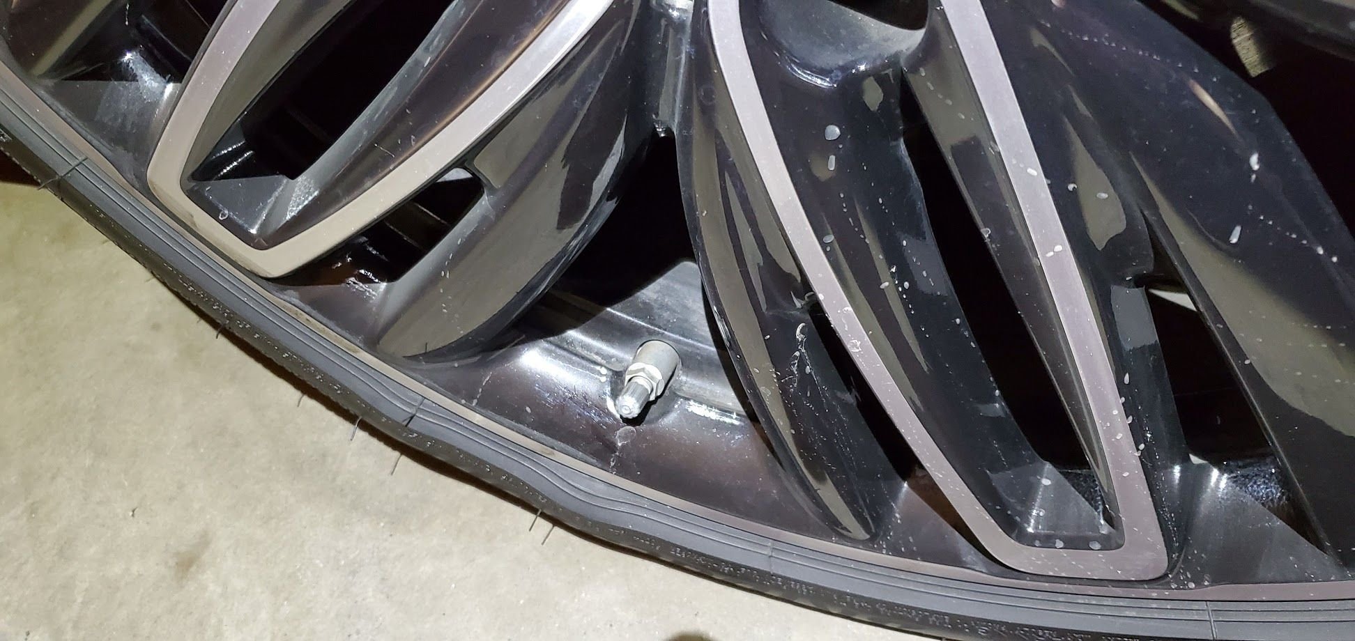

The Bridgestone Potenza S001 made it 2 weeks with the Denver potholes before they bulged. Mine came from Seattle and previous owner had the JCW 526 19" wheels on it with RunFlats. I've already added the Detroit Tuned spare and I think I'm going to go with the Continental DWS 06 235/35/19's from Discount Tire and adding the Road Hazard. They said any pothole bulges will be covered under Road Hazard. In the Fall I'm definitely going to get some 17's with some Michelin CrossClimate+ tires for the winter. For now I hope the 19's can make it thru the Spring without a major pothole bending them.
Pass. Side
Drivers Side
Fun Fact:
"Last year we filled a little over 67,000 potholes, that’s actually a little lower than we’ve seen in year’s past, we can fill anywhere up to 100,000 in a year," said Heather Burke, spokesperson for Denver's Department of Transportation & Infrastructure."

If that is a run-flat, you may have some small bend in the wheel as well. good luck with it. a regular tire will be a lot nicer ride and grip and be able to take the potholes much better! And out spare kit will be perfect just incase.

Hey Chad at DT, didn't know you were on here, I'm a new MINI owner. Here's my post about adding your spare, I was planning to get rid of the run-flats asap anyway.
DT Spare Tire Fitment
