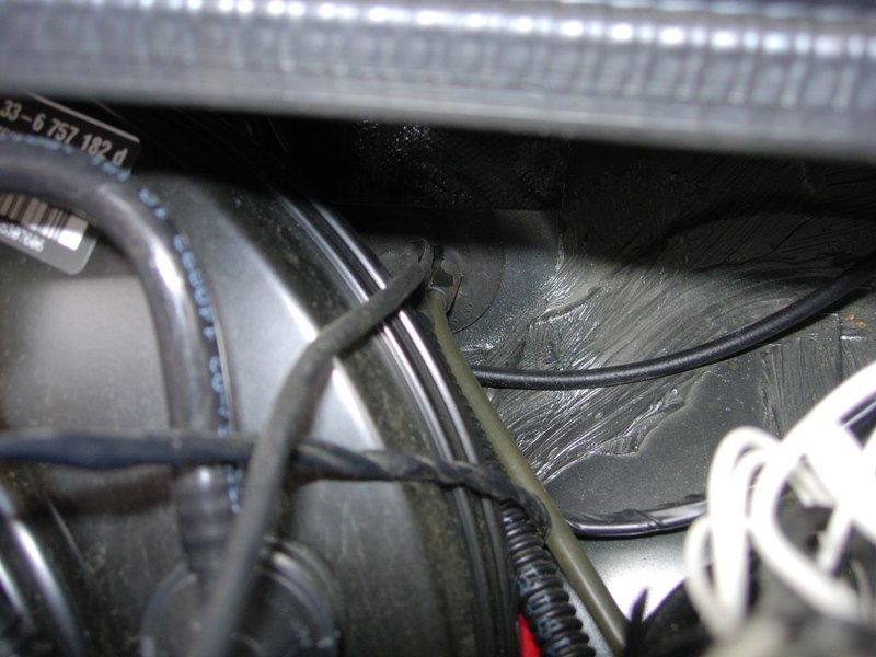

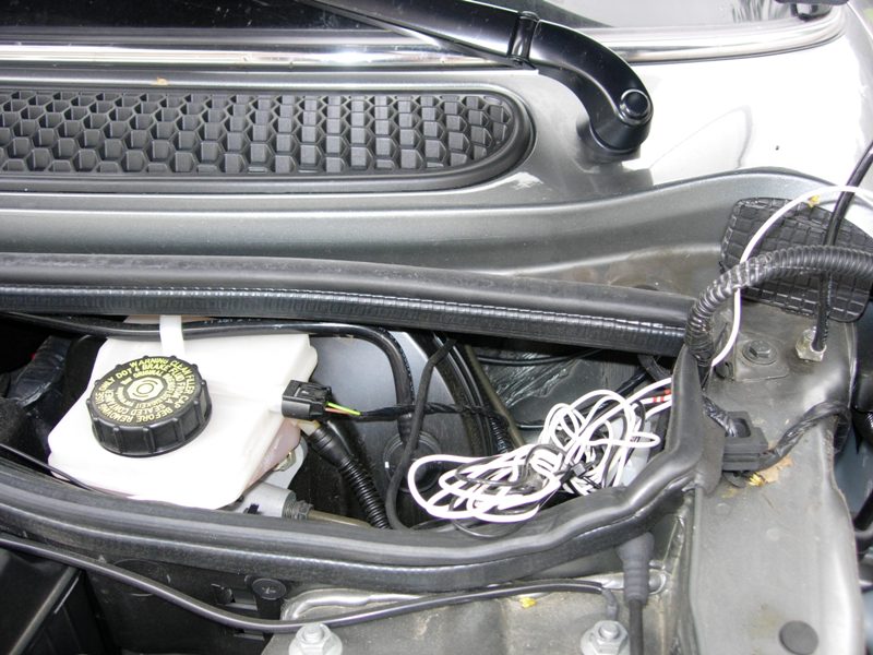

when you open the bonnet there is a little hole by the drivers side hinge. here there is a little rubber grommet that goes into the cab. i had to tape the wire onto a hanger and push it through. (it was easier than i thought) once through, just pull it to where you need. no problem.

oh yeah, the 2nd picture... my fog light wire is the top one. that is how i did it, i dont know if its the easiest or the best. but it worked great for me.

Excellent, thanks guys and thanks for the pics foster200.

Foster200 you're going to want to wrap that wire (or run it inside that handy wire loom) so the insulation doesn't chafe and create a short.
