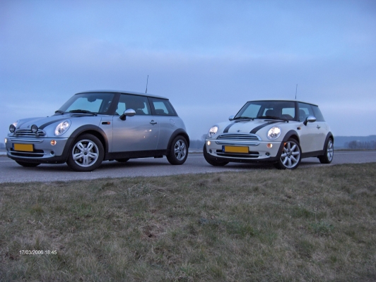

Our MINI's; Silver is of my brother and the Pepper White is mine. Both are they MINI One with a Pipercross openairfilter, but the mine is remapped (90hp -> 130hp). I'm faster than my brother!
