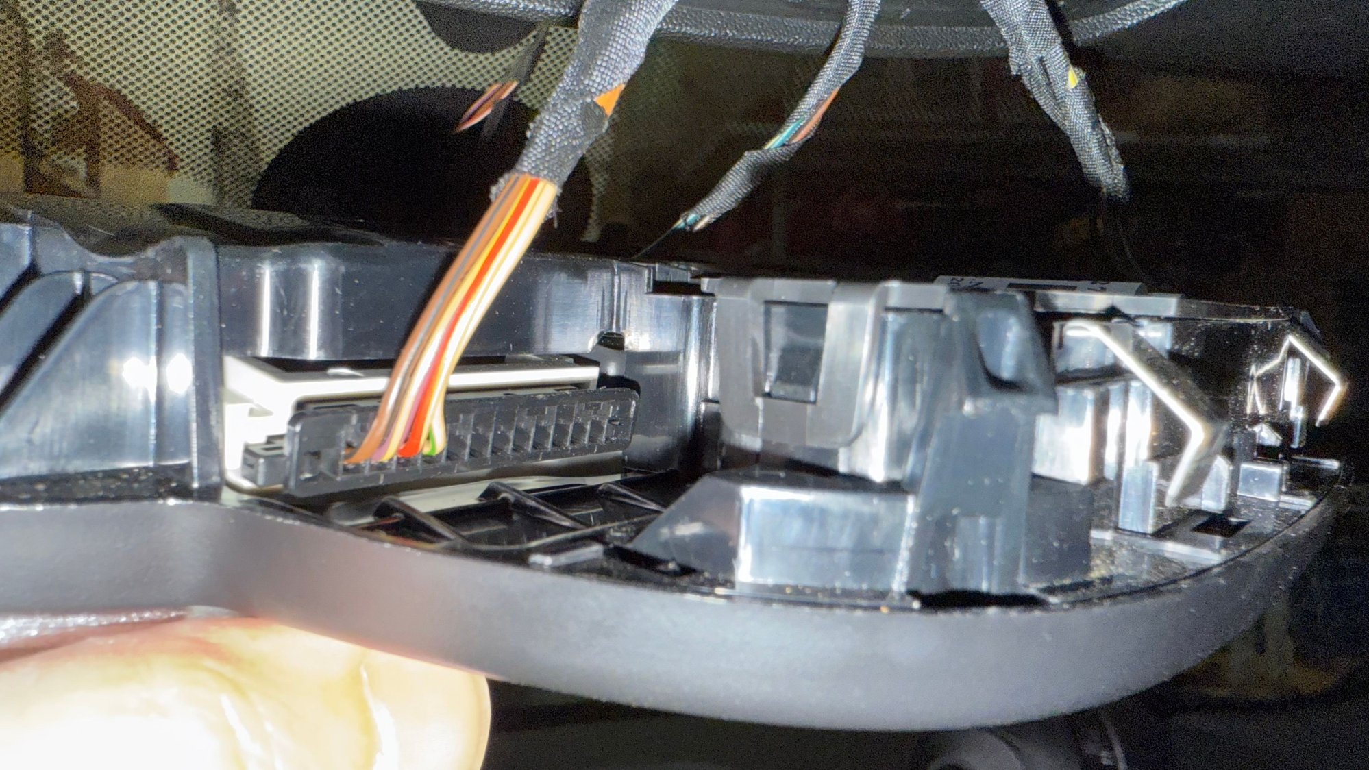

My 2019 F57 has a basic mirror - no home link and no auto-dimming - but I’ve purchased a mirror from a 2016 Countryman (same mounting bracket on the windshield), and I’m trying to get it wired up. Anyone willing to post some photos of the wiring in their car? Here’s what I need.

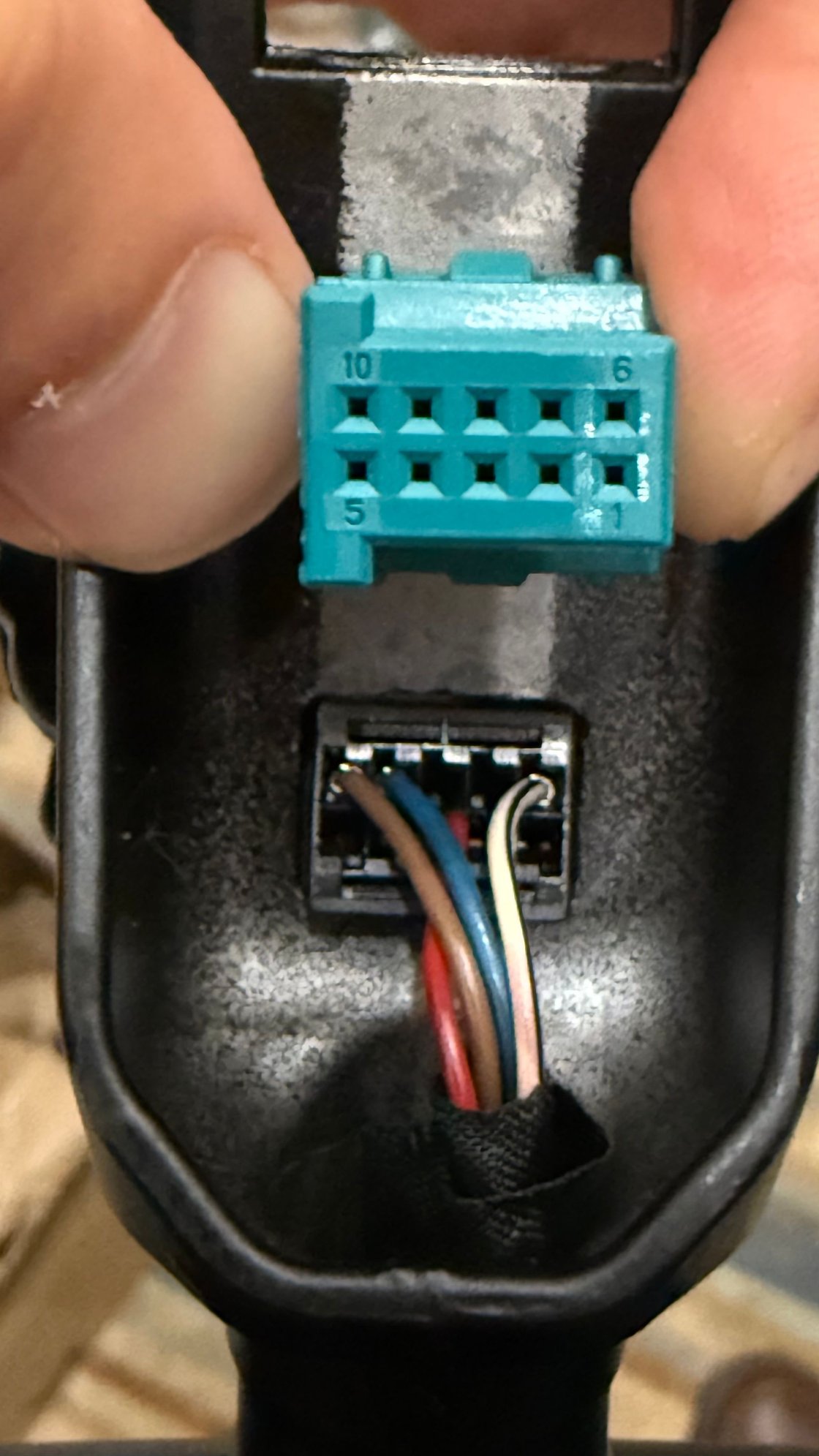

The wires coming out of the mirror go into a female wiring connector. I have purchased the male connector - it’s the blue piece in my fingers in the first photo, and will insert wires into the slots for pins 3, 6, 9 and 10 to match the arrangement coming out of the mirror. The first photo I would like is one that shows this male plug, and the colors of the wires that go into each pin.

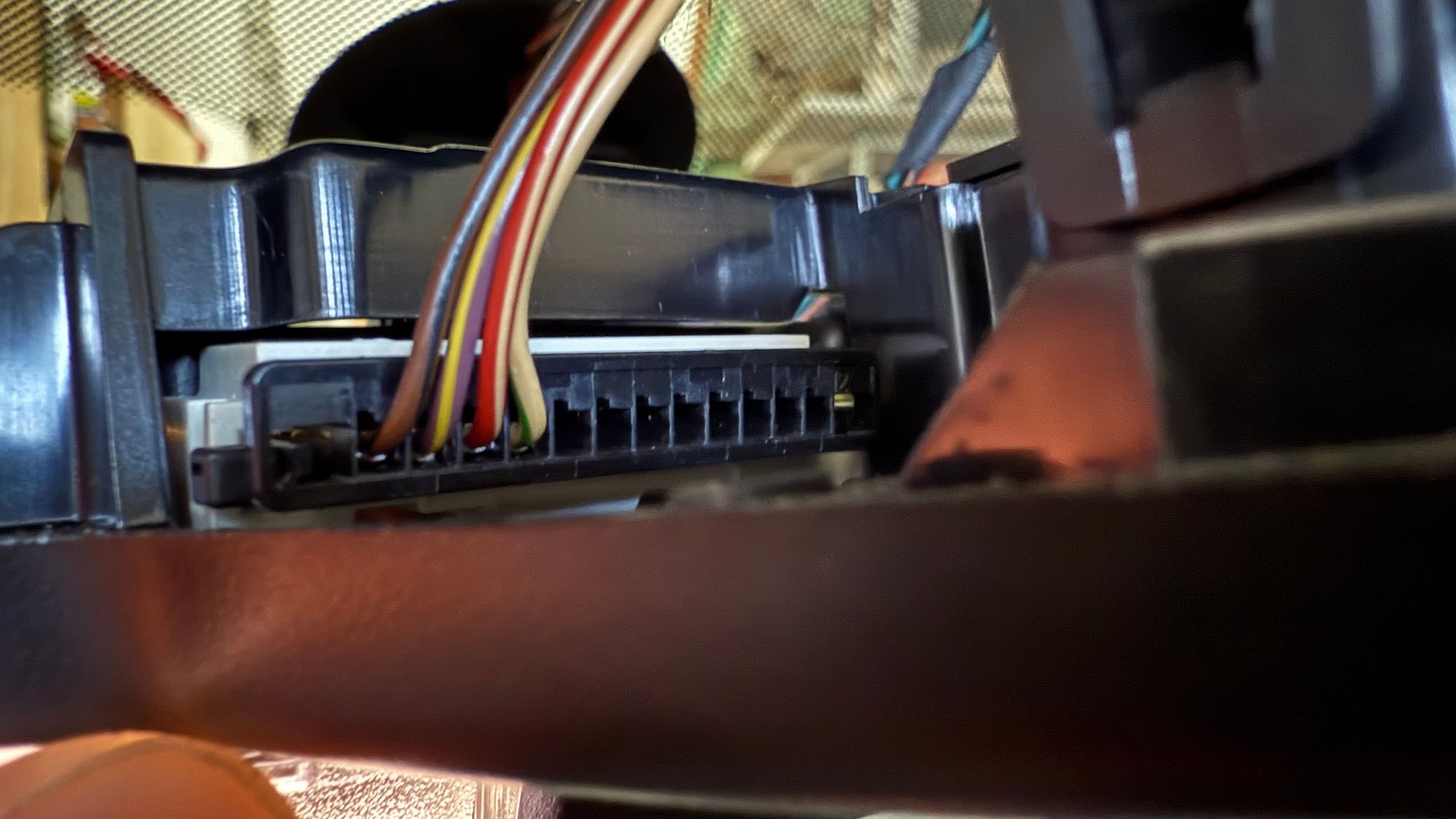

Those four wires go into the roof lining and into the switch console between the visors. I’ve opened that console (second photo) and I know from other sources that the wires need to connect into the long wiring harness connector (part E131*2B), shown in the third and fourth photos, but I don’t know which pins to connect to. The second photo I am hoping for would show the colors of the wires going into each pin on that connector.
Then, based on the coloring of the wires, I can figure out which goes where.
