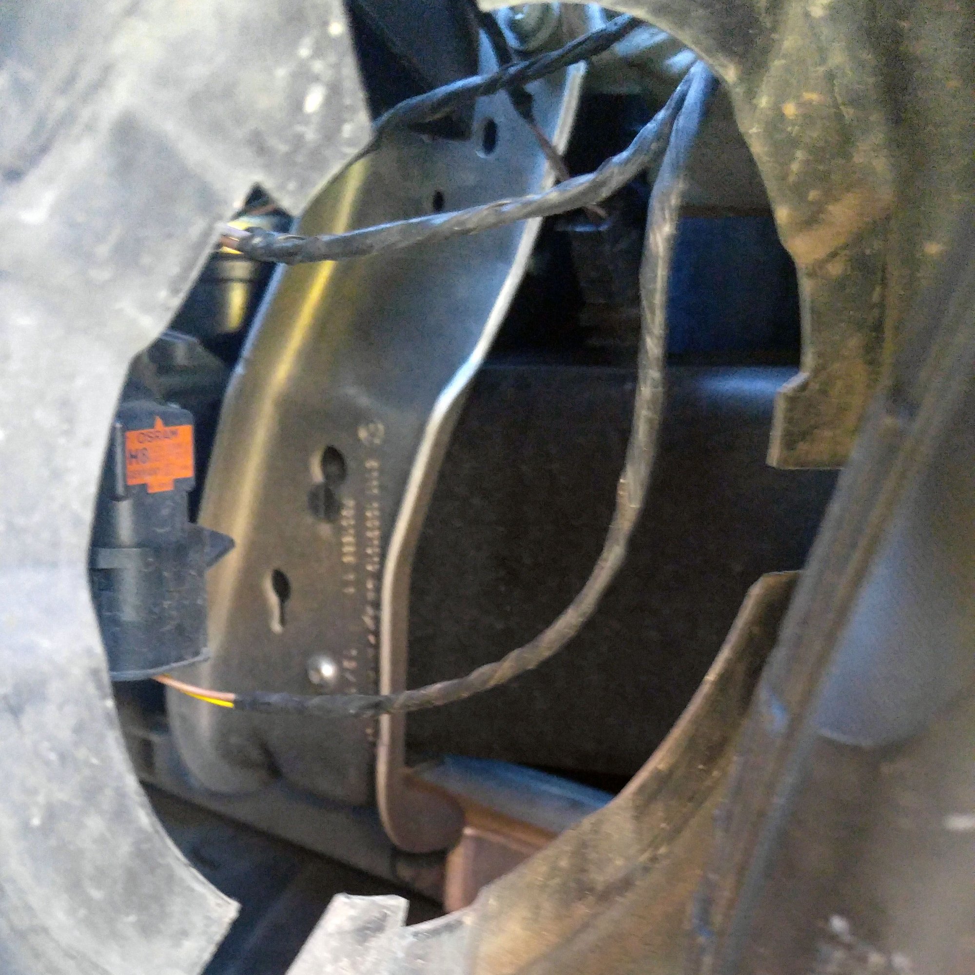

Along with the headlight, I wanted to change out the fog light bulb to match the same bright, white light. OEM fog light bulbs are H8 bulbs. H11 bulbs are similar to H8 bulbs, but have slightly different tab pattern and are 55W compared to 35W for H8 bulbs. H11 bulbs can often fit in H8 housing and I wanted to give higher wattage bulb a try since they are often interchangeable with minimal modifications. I am happy to report that H11 bulbs fit into F56 fog light housing with no modification needed!!!
Fog light, DRL, and parking light are housed together in lamp housing that is accessible through an opening in front wheel liner.
Cap to the lamp housing twists off. Turn the tire to the opposite side to more easily access this opening.
Once the cap is off, you can see the three lamps inside the lamp housing.
DRL and parking lamps are on top and Fog light is on the bottom
Connector to the fog light pulls off and the bulb can be twisted off from the lamp housing.
Even though the OEM fog light bulbs are H8 bulbs, I wanted to try brighter H11 bulbs.

How do the H8 bulbs come out? I was just under there and fought resistance no matter which way I tried to twist the bulb
Same here. Even the manual indicates the bulb should twist out, counterclockwise, but I met firm resistance to the point that I was concerned about cracking the housing if I applied more force. Holding off for now.
annnnd what happened. i can't turn mine to come off.

I'm trying to replace my fog light bulbs on my 2016 MCS F55 but it doesn't look like your picture, there is a gray hard plastic grill like cover to much of the back of the fog light. When you installed your fog lights was there anything like this?
This is what mine looks like
That looks to me like you have the LED modules. What does the front look like?

I do have the LEDS would there be a way for me to change these fog light bulbs?
