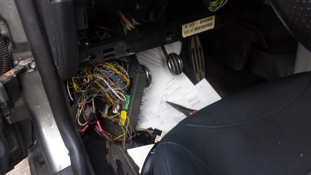

I bought this R53 with these wires and fuse panel like this. I can't find a picture or reference as to how this all goes back, like where the wiring routes and where the relays down there go and what the fuse box attaches to. If anyone could help out or get a pic of theirs with the kick panel off, I would very much appreciate it!!

Holy crap what was the previous owner doing? I see a few butt connectors so they were splicing something. Not sure what you would want to splice down there?
Alarms would generally be tapped under the steering column to tie into the starter disable.
Very odd.

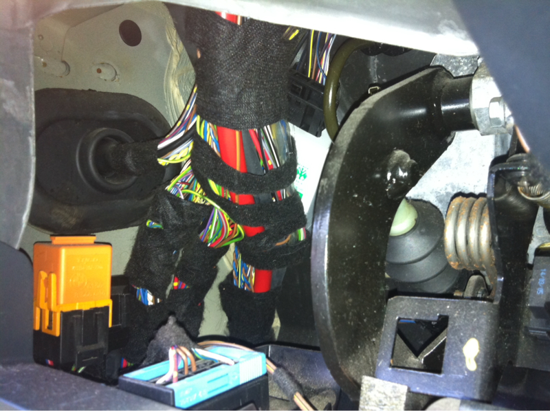

Here's a shot I just took of my 05.
Pretty much viewed from under the steering column. OBDII connection is at the lower part of the image.
Hope it helps!

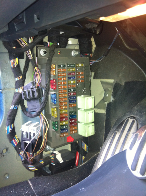

jamez, That was exactly what I needed!! the part I couldn't figure out was where to put the relay hanging down. lol. Does the fuse panel bolt to the chassis somewhere under there? Thanks a million for the pic!!

Okay, that was much more work than I thought it would be to get at....
Hope these help; I gotta go put it all back together again without breaking any of it
Very odd.
That was from 9 months of "diagnosis" between a MINI dealership and an independent "MINI Specialist" into a no start issue. The specialist thought it was a K-line issue and pulled all the wires out and apart to test each one separately. I correctly diagnosed an EWS issue the first 3 days I had the car, and after having RPMS work on my DME/EWS, it cranked right up. The previous owner was astounded that I had it running so quickly. So that is the story of the spaghetti in the floorboard. I guess if you want something done right…

Though it may not be in there completely correctly, the spaghetti is resolved and the panel, after MUCH fighting and "sweet-talking" is back on. I can't believe how difficult that side panel is to get in there, BTW. I now have an even greater appreciation for the effort it took to get the photos for me. Thank you again!!
