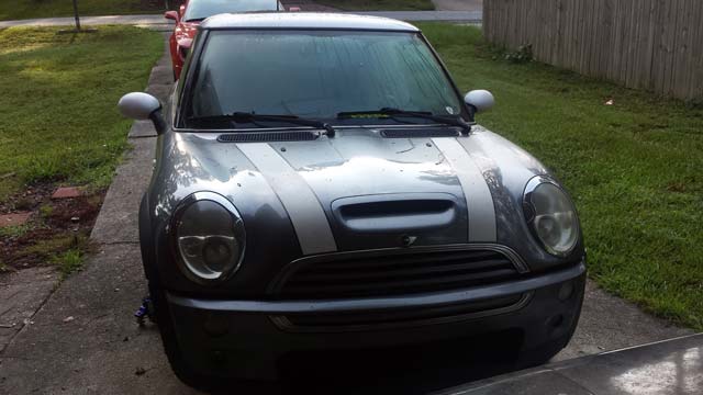

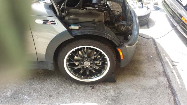

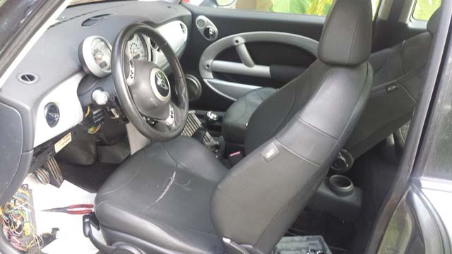

Pics!!
I promised pics, so here they are!!
On this one you can see a terrible patch job, which I get to dig out and re-do.

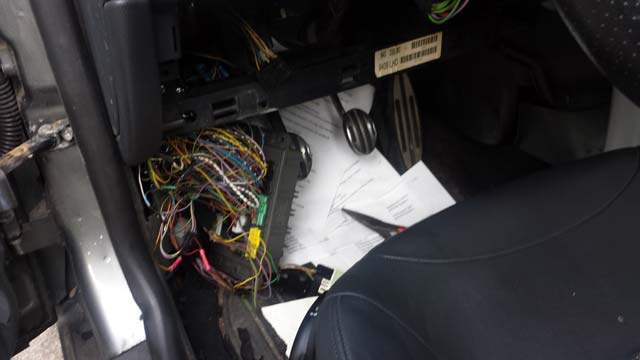

I have no idea how this spaghetti goes back in there… if anyone has a pic or can just tell me, that would be most helpful!!!
Well, there she is. Hopefully she'll be looking and running much better in a week or two!!

Good luck with the spaghetti! That is not something I'd care to work on!

Wow, this is a project, glad you are bringing it back, If you need parts. We have them here. Was someone going to use this as a parts car ?
www.ecstuning.com
When you do get the fuse panel in order I beleieve a cpuple of the wires are loomed together. The cloth webbed tape is good for this. Cloth Webbed Adhesive Tape. Thats what they used from the factory on the wiring harness.
http://www.ecstuning.com/Search/SiteSearch/Bmw_Tape/

I got my spaghetti sorted, and that panel back in. I'm leaving the other panels out until my AUX adapter comes in.

If someone could check out the pic of the boot in an earlier post, and give me advice on digging out that horrible patch job without A. Ruining the sheet metal around it. B. Costing a fortune. C. Taking an inordinate amount of time. I would be forever grateful, and if you're local-ish, I'll buy you a drink of your choice. Including single-malt within reason. I'm not sure if that is Bondo or JB Weld or something else. I do know it's hideous and need to be repaired correctly. Thanks in advance.

On that rust spot that looks like it was fixed with bondo ? , I think you are right out of the rust warranty year, 6 years pre 2004 , 12 years post 2004+ I believe is the body and rust for MINI. Looks like someone tried to fix it, common on salt belt MINIs driven year round with high mileages.
