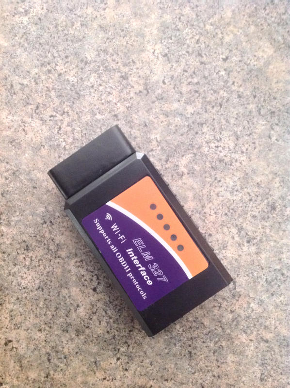

So I tried the el cheapo elm on my wife's 2010 MCS without any issues whatsoever. I'm now thinking that I might want to contact the dealer for a possible faulty obd2 port in the car itself.
