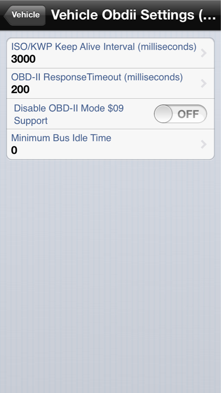

Palmer said to try to disable the obd2 support $09. Do you guys have that set to on or off? It's under the vehicle management, obd2 settings.

Old Nov 14, 2013 | 09:39 AM
pepperwhiteknight's Avatar
pepperwhiteknight
Joined: Aug 2013
Posts: 59
From: Texas
Off
Old Nov 14, 2013 | 09:40 AM
cerenkov's Avatar
cerenkov
Joined: Jul 2013
Posts: 3,101
Likes: 29
From: Raleigh, NC
Originally Posted by madmaxxed
Palmer said to try to disable the obd2 support $09. Do you guys have that set to on or off? It's under the vehicle management, obd2 settings. Sent from my iPad using NAMotoring
Here's a pic
