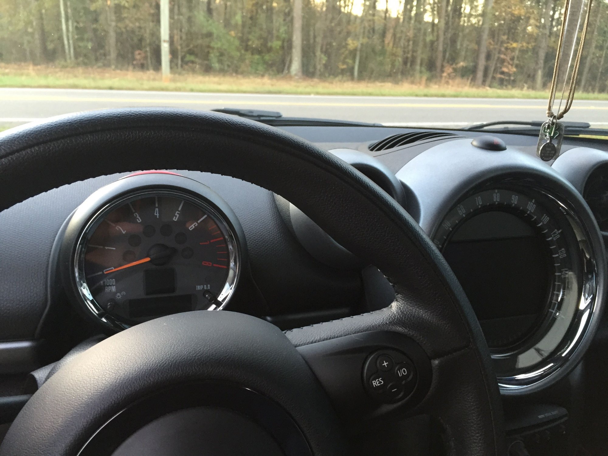

Black connected speedo=done
Installed my black face speedometer today. It looks much better than the silver/white that stood out to much. $300 on eBay with free shipping. There was no way I would ever pay over $800 bucks for that.
Old Oct 31, 2015 | 03:50 PM
M'Cooper's Avatar
M'Cooper
Joined: Nov 2012
Posts: 299
From: New York
Plug and play?
Old Oct 31, 2015 | 04:26 PM
countryman-s's Avatar
countryman-s
Joined: Jul 2011
Posts: 524
From: Birmingham Al.
Plug and play= yes
Three plugs. Speedo, monitor power plug and video plug. It was a pain putting it in because you have to totally remove the center vent unit down to the dash. Lots of clips and torx. I know the tach will be easier, unless reprogramming is required.

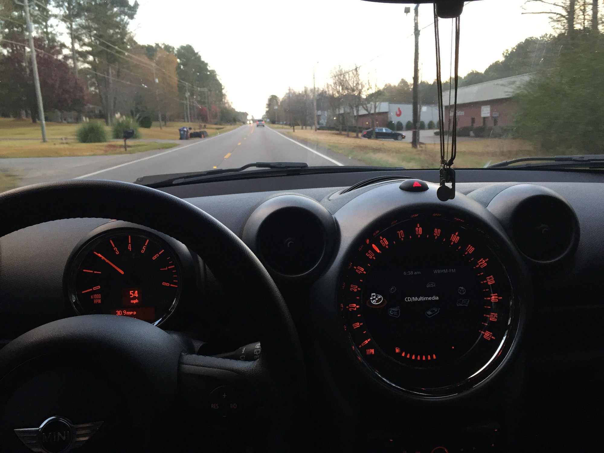

Swapped!
I have completed my swap to black face gauges. Bought them off eBay from a wrecked car. The only issue "besides installing" was the tach was from a auto and mine is manual. The display said "transmission malfunction". So I opened them both and swapped the faces. The needle was also different on the black. It is black instead of silver so I had to align it back up. Done. It looks much better with the black/anthracite face. At night it looks like the numbers are floating. In the day, they blend in with the inside colors much better.

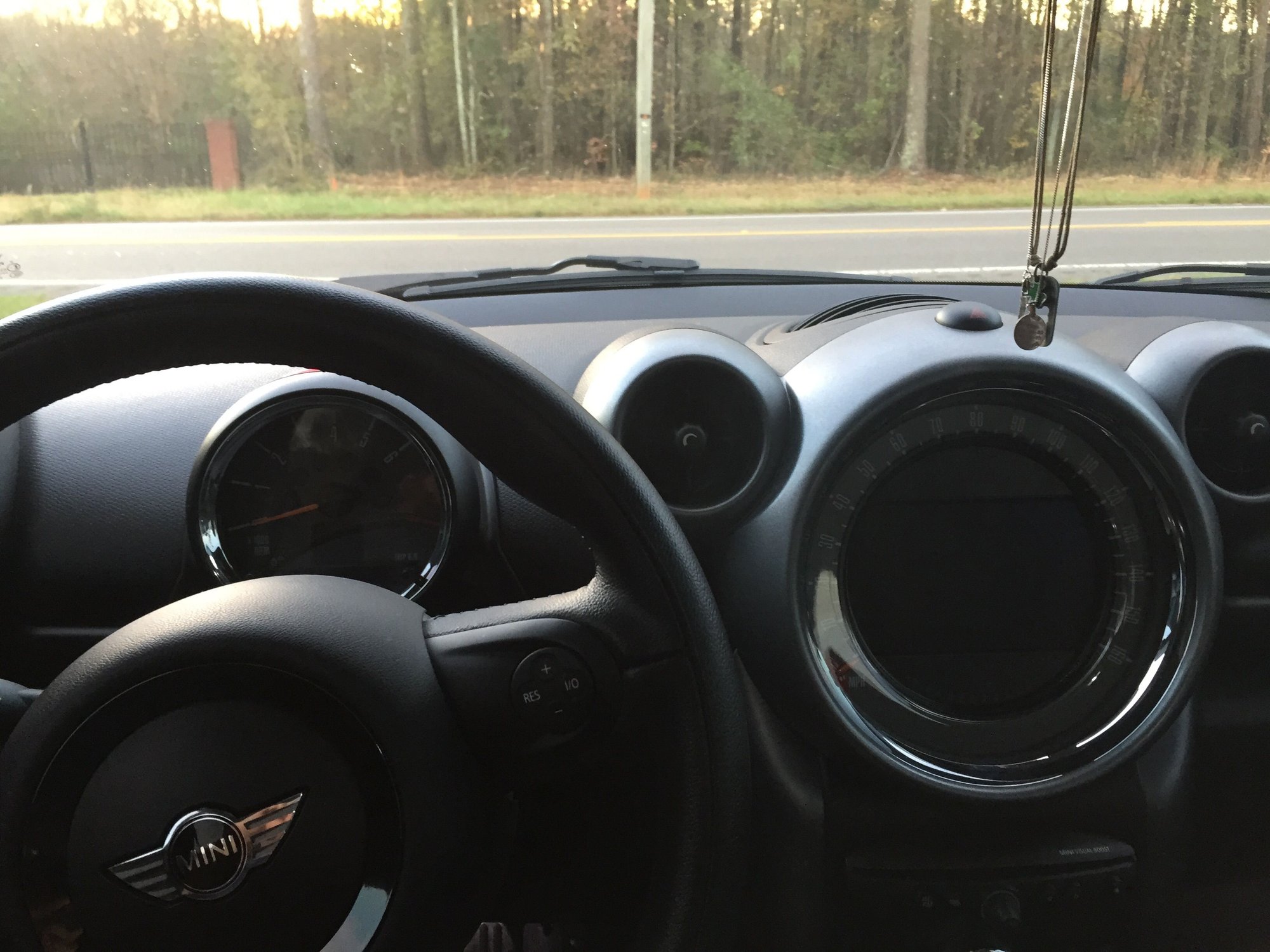

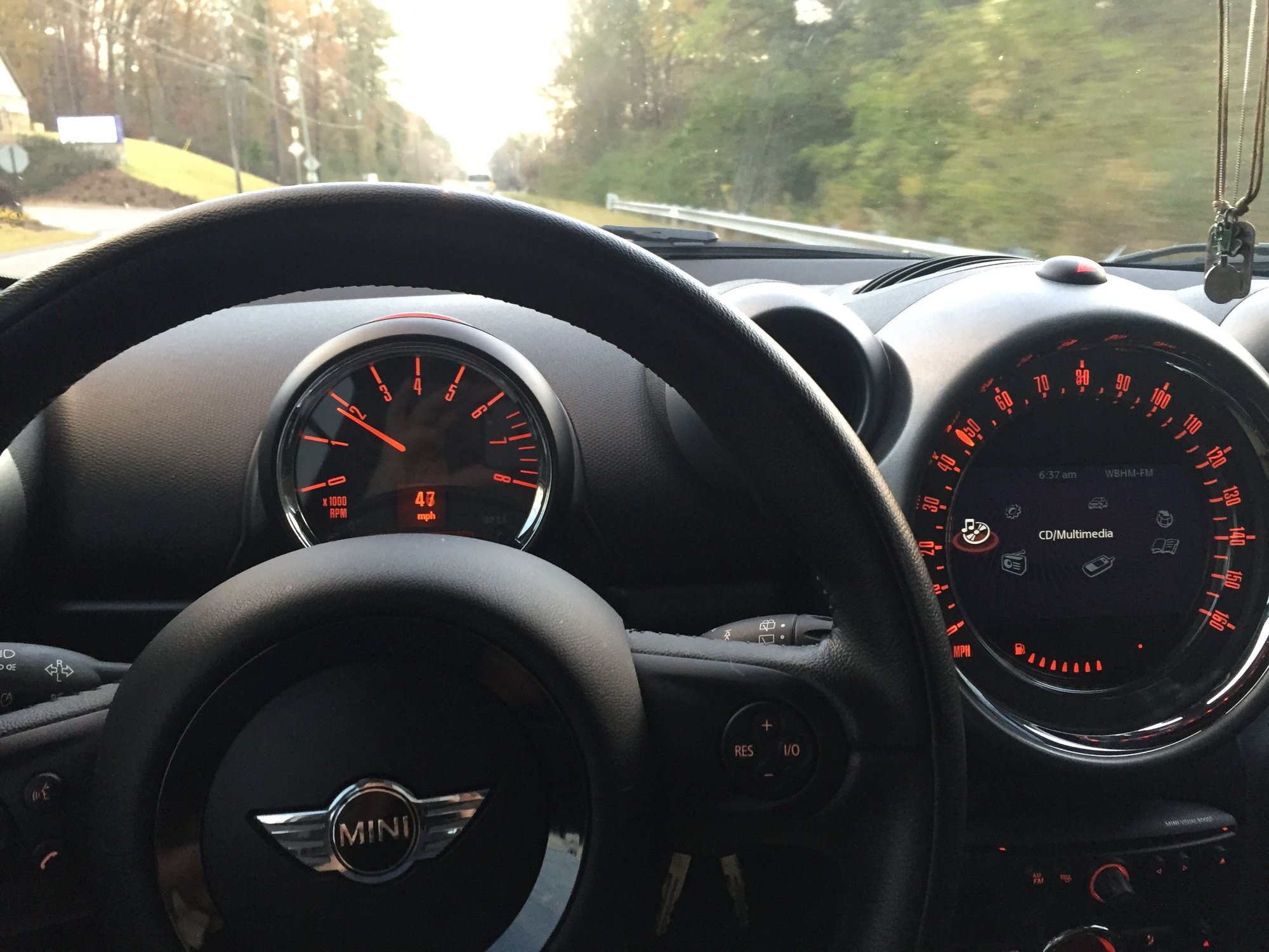

Did not take pictures of install in progress, but here is the end result. Much more low key interior look. Much better!!
