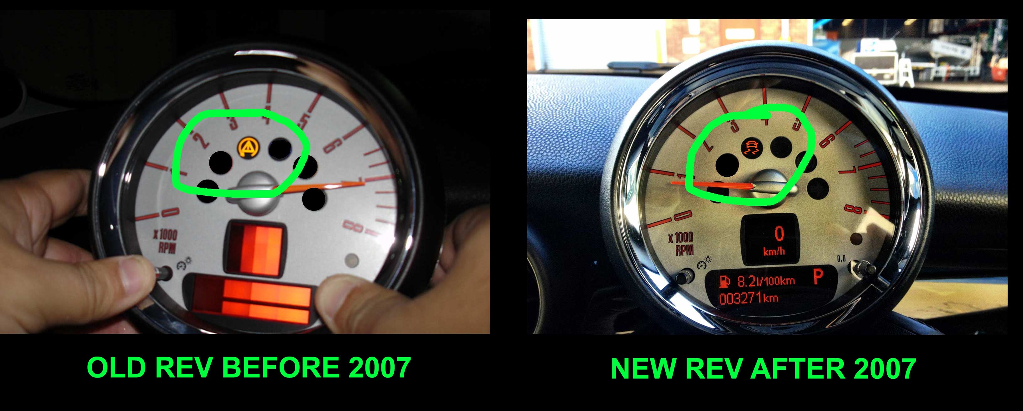

1. Yes it is true MINI calls the tacho "additional instrument" or KOMBI2 but that IS the main unit. Check the wiring diagrams on BMW Planet. It is the KOMBI2 that is connected to the CAN bus and not the speedo. I guess the naming has to do with the size. I know it, since I changed my speedo from mph to km/h, but didn't change the tacho. It was simple plug and play and the speedo was a used ebay unit. So all the information is stored in the tacho not the speedo.
2. Yes you can use Tool32 to make specific changes, but WinKFP will also write the VIN to wherever appropriate. I mentioned WinKFP because there are different firmware versions for the KOMBI. He may need to write a different firmware on the unit to make it compatible to his car. As an example, when I changed my speedo all was working fine apart from one thing: the CEL engine light would lit the DSC light. The reason is, I have a 2007 and later models have the CEL at a different location on the cluster (basicly they have an additional light). I had to do a firmware upgrade on the KOMBI to make it lit the correct location (but it did so, without any coding changes).

I have the same problem as mr. alexs3d2. (The CEL engine light is lighting the DSC light.)
I bought a used tachometer that is from a old R56. Our is newer from -2011.
How do you do this programming he is talking about, could some one please write it more detailed. (Firmware upgrade on the KOMBI to make it light the correct locations.)
I mentioned WinKFP because there are different firmware versions for the KOMBI. He may need to write a different firmware on the unit to make it compatible to his car. As an example, when I changed my speedo all was working fine apart from one thing: the CEL engine light would light the DSC light. The reason is, I have a 2007 and later models have the CEL at a different location on the cluster (basicly they have an additional light). I had to do a firmware upgrade on the KOMBI to make it lit the correct location (but it did so, without any coding changes).
