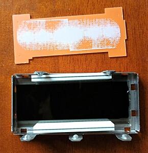

The speedo is easy to disassemble.
At first I was thinking the silver rectangle was of some importance because I'm a doofus with electronics and don't have a clue.

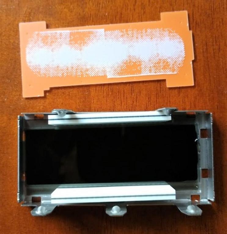

Turns out it's just a piece of glass and an orange filter:
I don't think our cars have ribbons?
I'm not really sure though, as I said I'm dense on the subject.

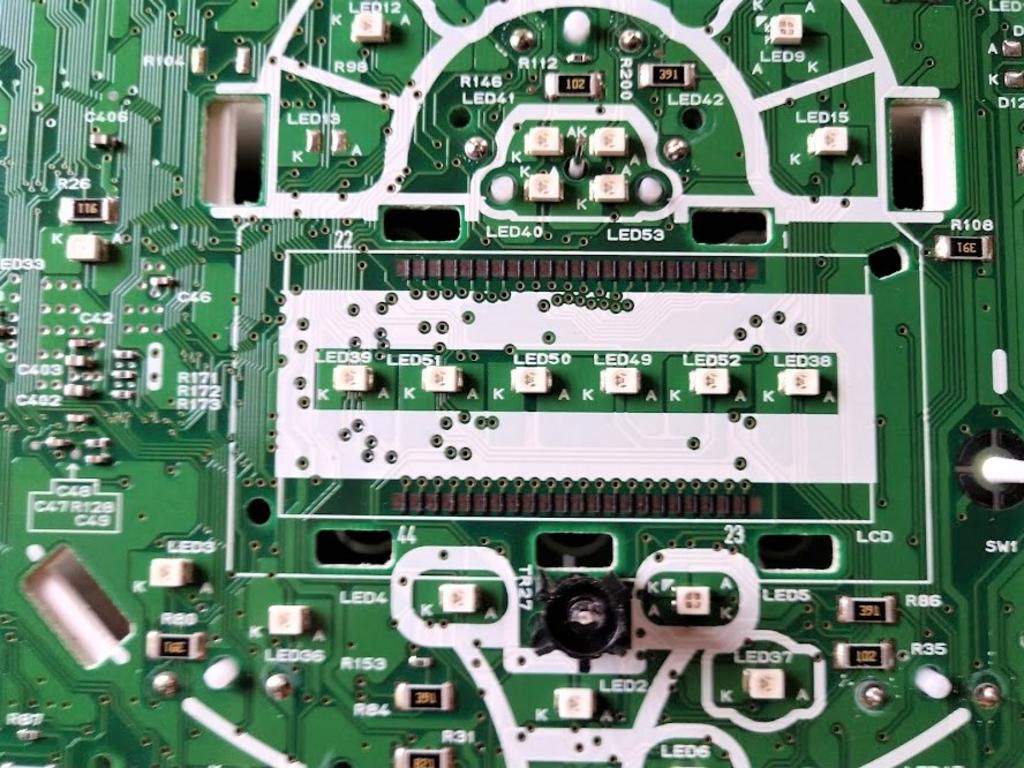

Here's the front side:

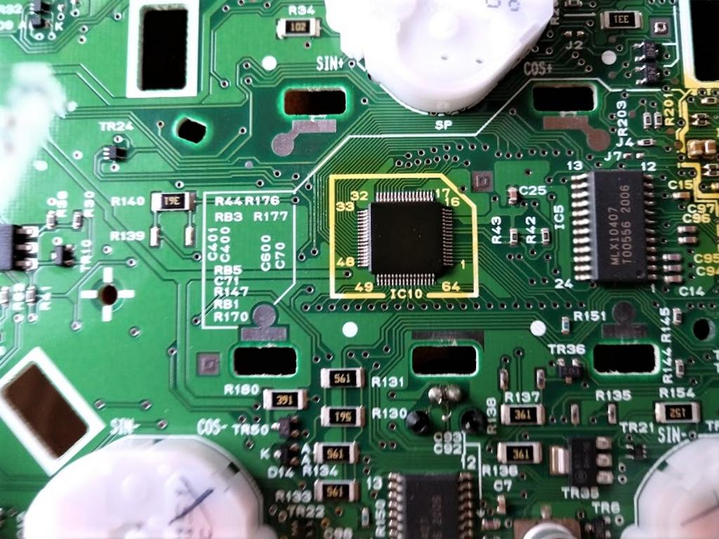

And on the backside directly behind that is a microchip:
I saw this video where the repair was involved with the microchip,
but due to lack of description or dialogue, I have no idea if he used a new microchip or just cleaned the contacts or something.
Any answers on this subject would be highly appreciated.
