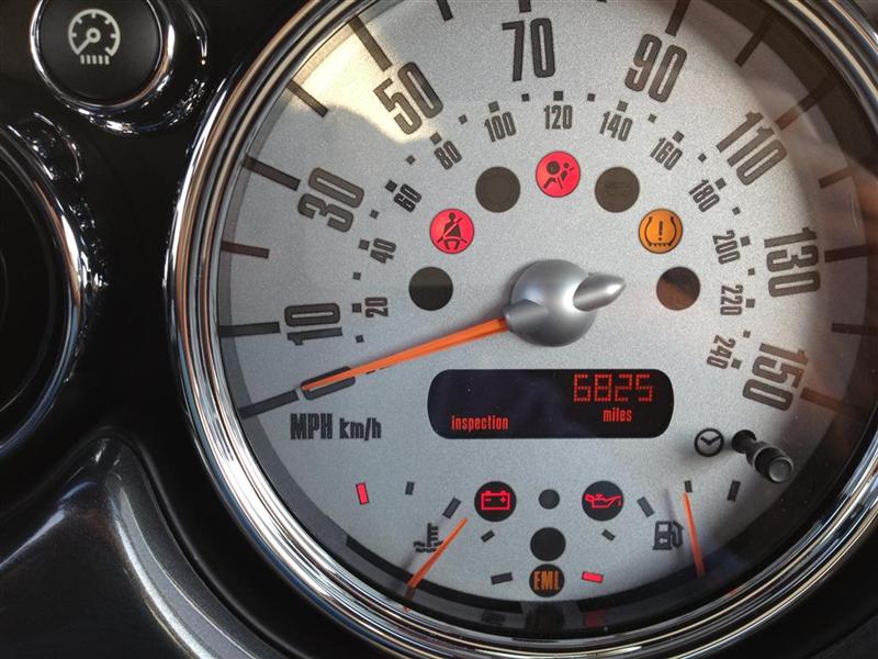

It worked. My oil change interval is now 6825 miles.
Originally Posted by claancy
Also, has anyone else done the window auto-up, as outlined here? - http://www.rogueeuro.com/forum/viewtopic.php?f=7&t=387
My BC1 trace doesn't have either of the "pinch" lines in it.
I tried this out, and auto-up works on the driver's window but not the passenger's. Any idea how to get it working?
Attached Thumbnails NCS Expert for dealer-programmable options?-img_0516.jpg

On the positive note, I was able to get the NCS Expert software up and running!
I was able to enable the following changes on my 05 R53 Mini Cooper S:
*European double-flash hazards
*Fog lights stay on if I turn on my high beams (NAS, or North American Standard)
*Sunroof open AND close from both the remote AND key in door
*Auto up (one touch) on drivers side window, (as mentioned above, wasn't able to activate passenger side yet)
*Removed leading zero on odometer
*Changed my service interval from 15,500 miles to 11,000 km (6,835 miles, shows up as such)
*Disabled turn signal flashes when locking/unlocking the doors, my aftermarket alarm already does that with parking lights
*Disabled hot/cold checks for all the bulbs so no more rave LEDs
*Disabled low outside temp chime
*Enabled low fuel chime
*Windshield wipers switch to really slow when stopped
*Disabled chimes for seat belts
Also currently trying to find the settings to make speedometer show correct speed..
