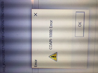

Coding error
Hello I am brand new to this. I got software and cable from Cable Shack in UK. Everything installs and looks like I can read the car, not sure how all the diagnostic software works yet. I am trying to add the retrofit bluetooth and rear fog light to my 2010 R55 and I get a COAPI -1000 error after at the $6ND code to the CAS for VO update and hitting the F6 or back key in NCSEXPERT. Any idea what I might be doing wrong?
