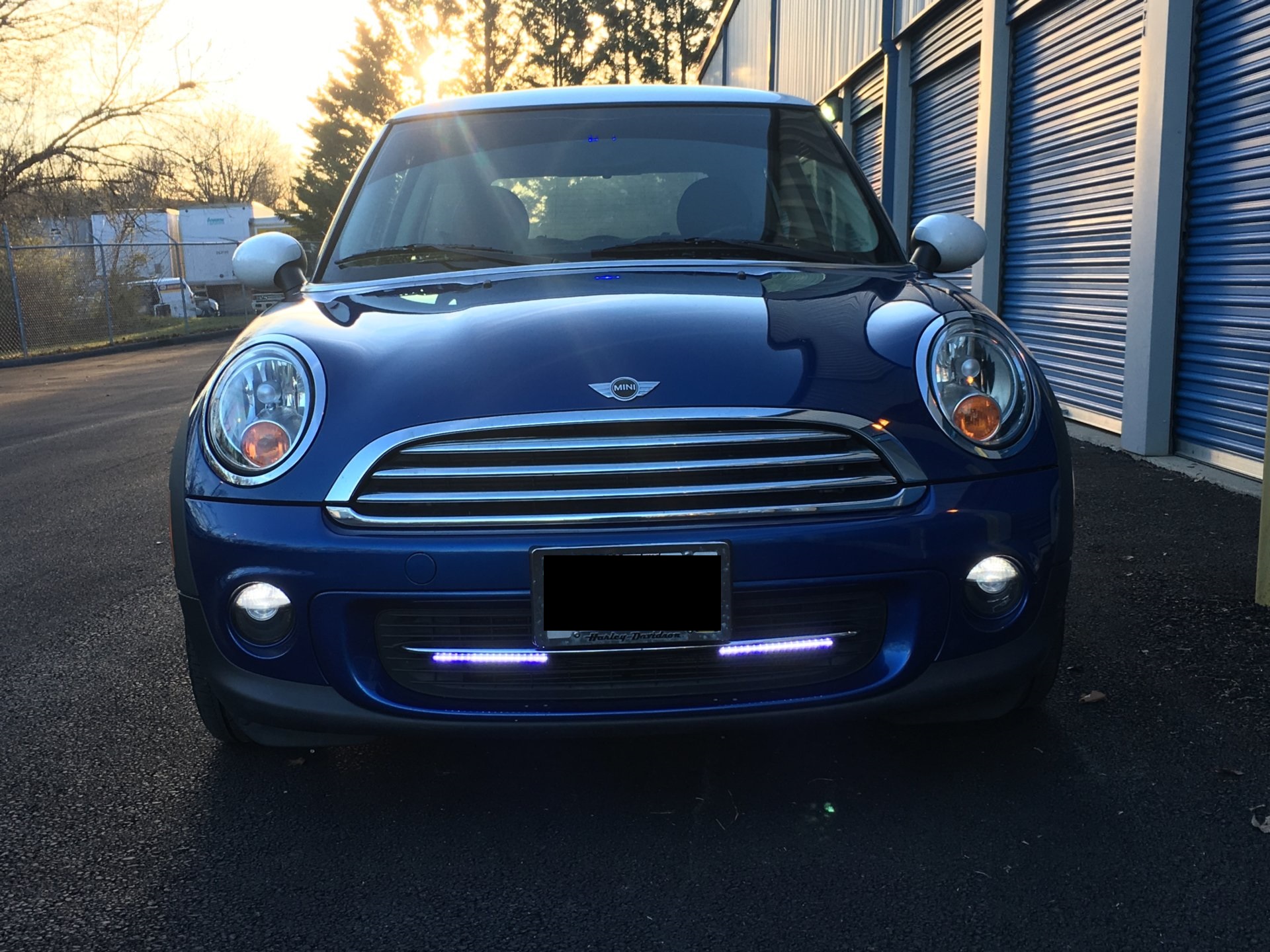

1st off, here's what I used in my 2012 r56....

for the exterior turn signals on the side fenders & the interior center "map" lights (I left the map lights by the rearview mirror stock cause the LEDs were blinding in your face....not a good idea when you typically use them at night LOL). I also used them in the bumper-mounted round upper "parking" lights...which I've had "coded" to run all the time as DRLs (see attached pic)
Amazon Amazon
also in the attached pic, you can see the LED strips I added for addl DRLs. They are "half-tapped" to the harness of the bumper-mounted light on the driver's side. I really like the look of them & heck they were only $8 LOL
Amazon Amazon
noooooow to address the "bulb out" issue......I never had an issue with any of these giving me the bulb out error code, but they did "flicker" both at start-up & going down the road. The reason for this is simple yet quite irritating. At startup, the computer sends a small amount of voltage out to each each bulb. If it gets the voltage back, then it knows the bulb is there because of the completed circuit. If it doesn't get that voltage back, then the circuit is open (bad bulb) & it gives you that error code. It also does this "bulb check" randomly while driving...aka a warm bulb check. This small amount of voltage isn't enough to power on an incandescent bulb, so no "flicker" but LEDs require such little voltage to operate that they blink when it does this check.
