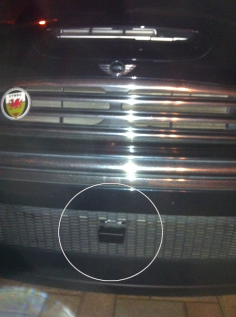

Qi45 install FAIL
Here is is picture of the install my mechanic did here in Puerto Rico. Not Pretty. I am desparately looking for a qualified installer here in Puerto Rico.
I have already bought a new grill and now I am looking for any insight on where to place the receiver.

I spent 2 hrs looking for a location.....almost, almost mind you, fit behind an Ociari Cowl Vent scoop
. But could not get a flat enough angle.
Would Even consider cutting a sqaure hole the aluminum bumper support and then making a window of sorts in the front bumper cover large enough for the receiver window
But no dice...it's just too long.
For now I mounted it high up in the corner of the pass side windshield with it's own bracket....what it loses from being behind glass, it gains from some added height ( being mounted low and also behind cars in front of ya can't be good for reception ) to receive deflected laser beam and the other bands....

Qi45 - I do not feel comfortable having it mounted beyond the grille exposed to all weather and road debris 24/7. I don't believe it was desgined to be subjected to that sort of extremes.
Just no room as it has to be mounted horizontally ( length wise ) and really needs a unit which mounts vertcally like the older versions of the Whistler Spectrum Remotes. I had one of those in a GTi.

Dimentions are: 4.5" x 3.0" x 1.5". Just measured it for you.....The roominess or lack thereof is pretty close between our two models. But probably just a bit more room in the R56's cavities....maybe.
On this project I just ran out of options and eventually exhausted all resouces for mounting locations. Sad too because I really like the way it functions.
