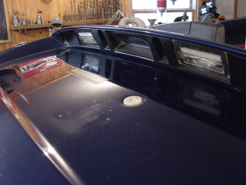

ran out of NAM room,,
cleaned up

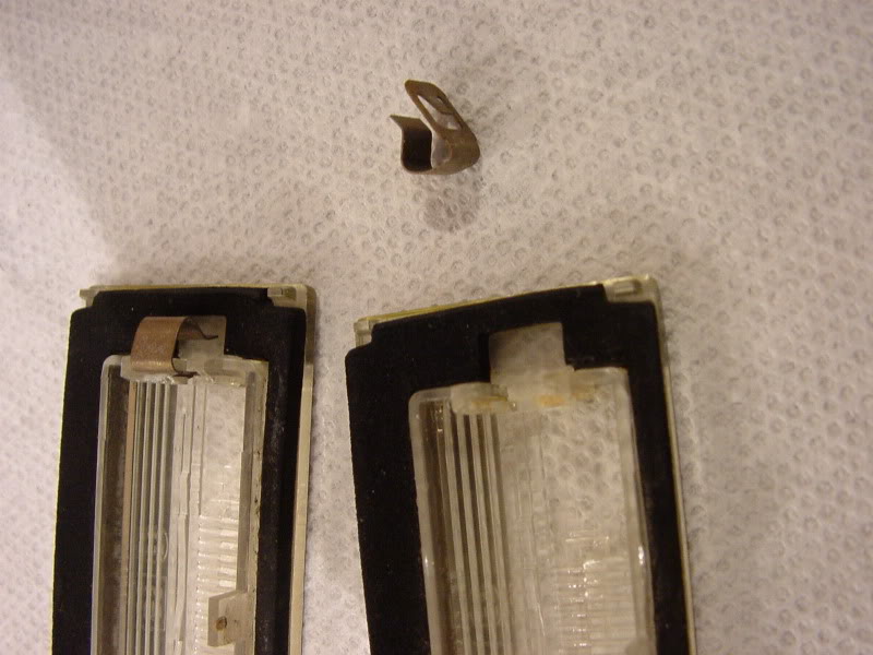

close up of the clips that could go lost

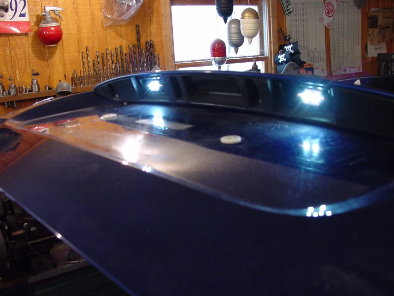

lit up with LEDs with no lens

photo of the finished effect, looks nice in person.
