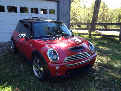

So, I took my 2005 MCS, with original Xenon HIDs, to a MINI mechanic, and he was able to swap out my original headlights for my new halo projectors with no problem. Of course, I have no washers or levellers anymore, but I don't care. I think the new lights look fantastic.
It seems the levelers are just an uneeded, technical complication that has very little benefit. After all, how often do we drive with just the driver and two heavies in the back seat.
Thanks for talking this one out everybody - nothing worse than finding a thread with your exact question only to have it fall apart before the question is answered! I'm doing it because I love the smooth headlight rings (non washer). To the OP's point, I won't miss the complexity/accessory price when things start to fail on my daily!

I went with these:
http://www.xtralights.com/02-06minic...blackpair.aspx
They look like this:
Funny (to me) thing was that the seller swore up and down that these would never ever ever work in my car because it came with xenon. They work just fine. Also, the seller swore up and down that the taillights I also bought were a simple drop-in replacement for my stock lights, but I actually had to go to a junkyard and pick up new circuit boards to get them to work.
