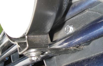

Pilot Automotive PL-195FC Fog Light Kit
[/IMG][IMG][/IMG], $34.68 & this item ships for FREE,
comes with wiring kit, and the bracket supplied works great, fits in slot in grill on my 2006 S MC, do not vibrate, black housing. 55watt 4" round 2 3/4" deep
will post pictures on car asap.
[/IMG]

From: NJ
amazon.com, and you get free shipping, they seem to be brighter then the lower stock driving lights, could be location, but they defiantly help, i have them set to show up just below the normal low beam light, i used the 2 factory slot locations to mount the supplied 1/2" wide angle bracket, all the modification to the grill i had to do is drill half a hole above the slot the size of the bracket hole, the bolts suppllied were short by a 1/2", so i just got 2 longer bolts, matching nuts, and washers the size of a quarter (just do not over tighten grill is plastic!), i have them directly connected to the battery, with the switch mounted under the steering column, there is a plugged hole in the cowl (just behind the power brake booster) were you can easally run the wires threw, (i have a 2006 mini cooper S with auto) in the future i may wire them into the stock driving lights and add a relay (the lights come with a switch and inline fuse) you also will need some more wire depending how you hook the lights up, i used the ground stud on the hood to ground the lights, note 2007 and newer grills are different, slots for the lights might not be there, check first!
