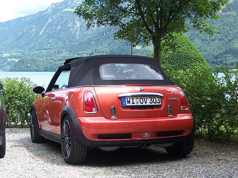

From: El Paso, TX
I did the exact thing you are asking for. You can replace the bottom light and wire it in to the backup light wiring so that you can see just fine. Here is a pic of mine. I can't remember who sold the light and wiring but I am sure a quick search through the popular vendors and you will find it.
