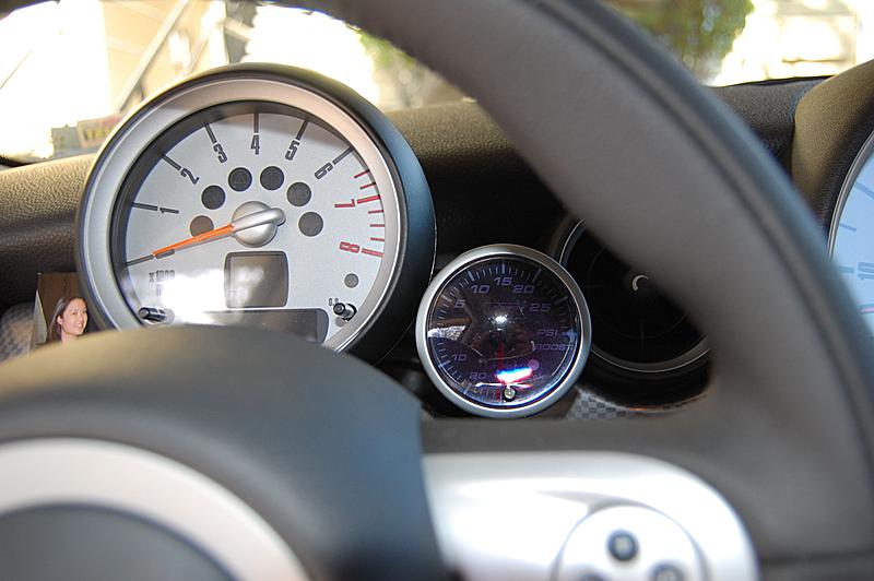

Got this done today with Masterd78's help, what a great guy for helping me thru the steps. Here's the single gauge, I have it on the right side, since my girls pic is on the left. Thanks for the help masterd78
Also, im not sure if everyone is the same but when i took my wipers off, i just unscrewed the nut, and bent it as if i were changing the wiper blades, and they came right off.

Thanks for the picture! so the instructions were good enough that came with it? Any little tips you found out as you went a long that werent mentioned., that may have been mentioned in this thread?

the instruction were ok, but masterd78 helped me the whole way!! It really isint that hard, hardest part was taking the car apart and putting it back together.

Looks Great!! I think it looks really nice with the Nav too. I am glad that my help came in handy Sirr6!!
