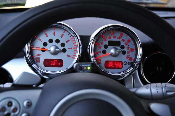

I own 3 Valentine One detectors and still think the V1 is a great device. Unfortunately my wife turns down the volume because of the false alerts around town. So for her new 2008 MC Convertible, I decided to try the Passport 9500i. The 9500i has the ability to store signals that you want to lock out via its GPS feature. When I received the box, I was not happy to see that the instructions recommended that you installed the device in the middle of the windshield to get a clear GPS signal. This was not acceptable situation. It would only be a matter of time before someone smashed the window to ****** the $450 detector. Fortunately, I tried it in my preferred location about the rear view mirror, and I am still able to get a GPS signal 95% of the time. Here are pictures of the 9500i and the remote SmartCord module on the steering column.

Yes the GPS is SiFRstar III. The unit gives visual and audio confirmations when the GPS signal is acquired. It is pretty fast (faster than the Garmin Nuvi 660 in my other car). I think the 9500i is perfect for my wife. For me, I like my V1. I react a lot quicker to the V1 and get on the brakes faster. The reason is that on the 9500, the first thing I hear is the voice warning ("K band detected") which doesn't prompt me to slow down immediately even though the remote SmartCord light is flashing on the steering column. Maybe the 9500 is too polite for my tastes.
I have read a number of posts about the difficulty of hiding the wire down the A pillar. Owners of the hardtop can easily hide it on the weather strip side. Convertible owners cannot, it needs to be pushed between the windshield and the A pillar. This is VERY EASY to do without removing the A pillar trim if you make yourself the right tool. I took a small piece of angle iron and bent the bottom portion into a J shape (leave the hook fairly open). You can use it to slip behind the trim, hook it and pull it towards you enough so that the wire can be pushed under the trim. You can use the same technique along the top of the windshield.

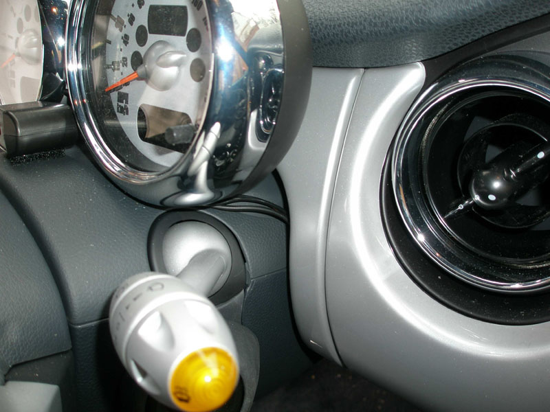

I ran the wires for the remote cord down the right hand side of the steering column. You can get the wires to tuck within the steering column cover. The wires then run back to the fuse box where I used an "add a circuit" fuseholder in location 36 to power the radar detector.
