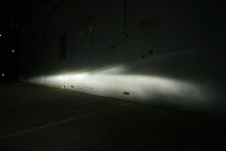

I took both pics, which are from my cooper. I think you can see which might blind people less... Output is about 50% better anyways, which is another incentive...
reflector w/ xenons (before retro)
projector (after retro)

Old Dec 15, 2007 | 01:02 PM
