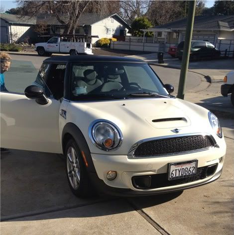

I recently took my CMS in for some service and got a loaner Mini. I NOTICED quite a difference in the R53 (I think) and would almost definitely replace the Run-Flats. But for my CMS, It's a lot better, not anywhere near as harsh a ride. I have All-season RF's.
This is the Mini I got to play with.
