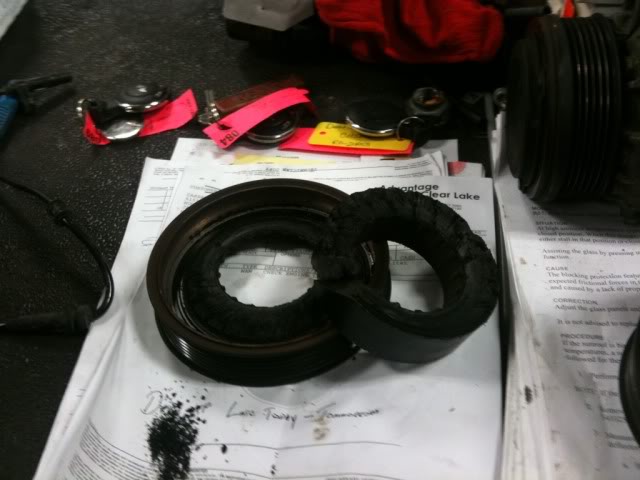

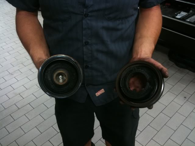

and they will fail, this is what happened to my OEM, when i took the belt off it fell into three pieces.

Old Mar 7, 2012 | 07:34 AM
Crey23's Avatar
Crey23
Joined: Dec 2010
Posts: 65
Cole, are you saying that your dampener fell apart when you changed the belt? Did I get that right...how many miles did you have when that happened?
Old Mar 7, 2012 | 07:53 AM
Cole9953's Avatar
Cole9953
Joined: Feb 2010
Posts: 372
From: Seabrook, TX
about 60k miles when this happened. I was able to drive it home after it let go, about 25 miles at 40 miles an hour in limp mode. the rubber that connects the two sides of the pulley broke, but would still grab on itself and not spin unless i gave it two many revs, or turned the ac on. with two many revs/the ac on, the resistance from the accessories would overcome the rubber causing it to spin on itself and go into limp mode.
After i got home i checked it out and saw that the dampener wasn't right, so i took the belt off, and was Able to pull half the pulley of by hand. the rubber was no longer connected to either side of the pulley
Old Mar 7, 2012 | 08:09 AM

Man, that old crank pulley looks scary!
