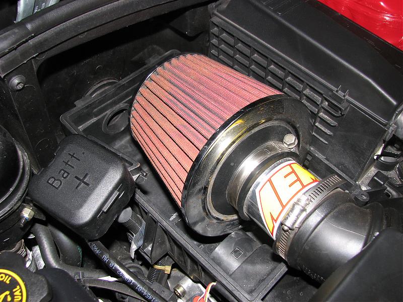

Hi,
I have a 2006 min cooper S. I took the stock intake box out and decided to put a filter on it. i still have the original rubber hose on there and I wanted to take out the bottom part of the stock intake box because I don't see a point for it to be there. Does anyone know how to take out just the bottom part of the intake box?
Thanks!!!

The point of it is to hold the DME. You can take it out by removing the bolt on the front driver's side of the box. Then pull it toward the front of the car. There are two rubber pieces that hold it at the rear. They will slide out when you pull the box forward.

The ECU will not have a home.. (What 002 said)...
not having a nice secure/sealed place for the ECU seems risky.. But that is mod-ing..
You will also loose the air path from the front as well.. It might not be a "big path" but that is "ram air" coming from the front grill..
Bottom line.. pull it out and see what you can do with what is left.. But hold on to all the parts (just in case you want to go back to stock)

There are other considerations: it acts as a barrier to the heat coming from lower in the engine bay, in part from the header and shields. It also supports your filter from looking at your photo.
So here are the pros of keeping it:
1. It holds the ECU
2. It allows air from the front intake duct above the radiator to reach the intake filter
3. It acts as a thermal barrier, albeit partial
What you have is a HAI. Notice the H stands for HOT. There are many threads about HAIs and modifications to create thermal barriers to improve their efficiency. I've never seen anyone actually remove the lower box section.

The only reason that I wanted to take it out was i thought that I would get more air from the bottom, i don't know if that would help. I'm trying to get better sound without replacing the rubber hose. I don't know if there is going to be a difference, but the ECU scares me now.

One more thing that I forgot to mention is: Is the box to the right with cables also attatched to the inatke box?

If you're looking for more air, you should remove the piece that is separating the driver side cowel area. It's best to leave the bottom of the box alone. The benefits (if any) won't be worth it.

The box you refer to is the DME (ECU) - the cables that connect to the DME, anyway. It is integrated into the airbox bottom. It comes out of the airbox enclosure easily, but does need a home.
