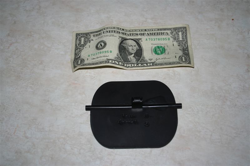

Preformed the JCW CAI Flapectomy today!
All I did was take the flap out and left everything else intact. Sounds a bit louder when getting into it below 4500. Here is what it looks like.

I've never bothered to attempt to remove it, is it a simple matter of pulling or what?
No you have to remove the whole intake and flap mechanism then replace it without the flap. I'm the least mechanical person on the internet, and I figured it out.

Did you take the plug out of the lower hole too?
Yup

I never noticed the dollar bill in my intake...
I found a 20!
